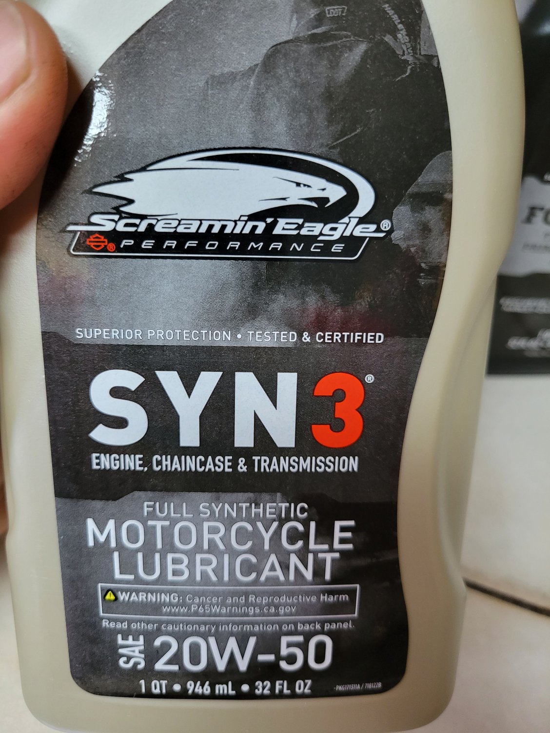

Figured this would happen like in every other fluid question thread...I went back to dealer and bought regular old dino motor oil due to reading past threads on this forum plus I don't put a lot of miles on my bikes. Between our 3 year old daughter/two dogs/dirt bikes and the boat I switch from activity to activity. Less than 3k in a year on the harley in very little stop and go traffic dino oil will be perfect. Plus from what everyone is posting dino oil in the 114 seems to keep the motor quiet compared to full synthetic.
primary is formula+ which i had and for now that synthetic trans oil till i order redline shockproof which is supposed to help quiet the clunk between gears. Personally I think it's due to the added weight oil since a trans should use 90wt minimum and not that super thin oil they use stock

The only issue I see there is that they should have sold you 5 quarts of engine oil. I never run synthetic oil in my primary. Belray primary oil in the primary and Belray transmission oil in the transmission but the H-D gear oil is good stuff also. I've always liked Amsoil or Mobil 1 for the engine. 4.5 quarts always puts me right at the proper level. 30 oz in the primary and 28 oz in the transmission. The hotter the bike the better for changing fluids.

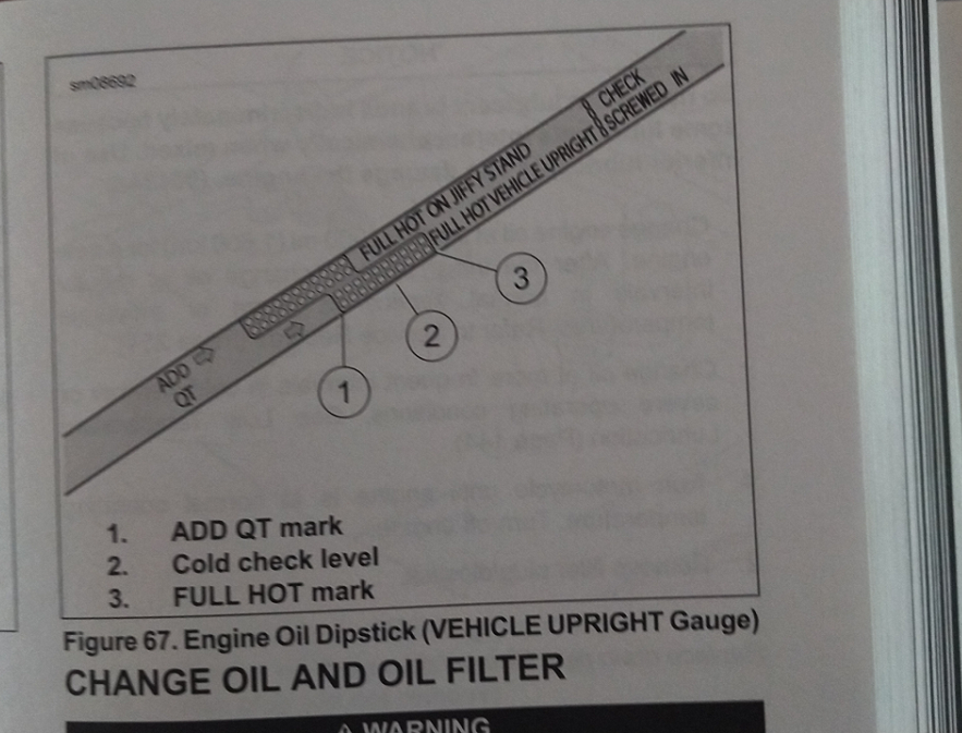

I don't know if they changed anything since 2017 as far as oil capacity, but my Road King 107M8 took 4qts & 4oz to fill the crankcase. After I rode my bike to op temp for the 1st oil change, I let it drain for about an hour just to be sure I got as much oil out as I could (it's a used RK, I had no idea what brand oil or how long it'd been in there). 4qts filled it to the "add quart" mark on the "full hot vehicle upright" side of the dipstick while it was sitting on the jiffy/kick stand.
The engine was pretty cold by this point, so I took it for another ride & checked the dipstick again on the jiffy/kick stand. It took 4oz to fill it to just a hair under full hot on the jiffy/kick stand side of the dipstick. If I hadn't of been so **** retentive about the 1st oil change, I'm not sure I'd have had to use an extra 4oz.
