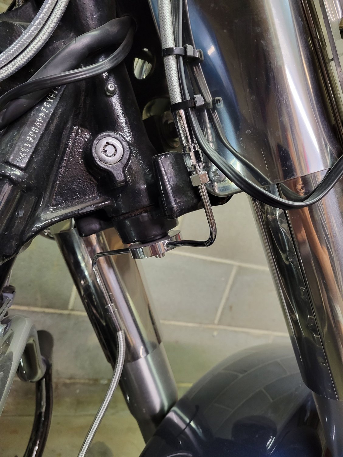

I am looking for help! If anyone in Touring Land may know either who may have manufactured this type of system or if you know someone that can make a longer SS braided cable for this system without having to replace the entire system, is what I'm looking for.
I am replacing my factory 7.5" bars with 10" bars and was told I would not need new cables on my 09 Ultra Classic but for whatever reason they will not fit, no matter how much I reroute the cables. I am 2" short (reserve your comments) on my brake cable but looking at it, it separates from the block connection using a simple male/female connector (see the pic) - very smart! I haven't seen this system on anyother bike and am unsure where to search and how to search for it. I basically need a 23-24" cable with a female connector on one end and banjo bolt for the master cylinder on the other. See the attached pics.
Any assistance would be greatly appreciated!

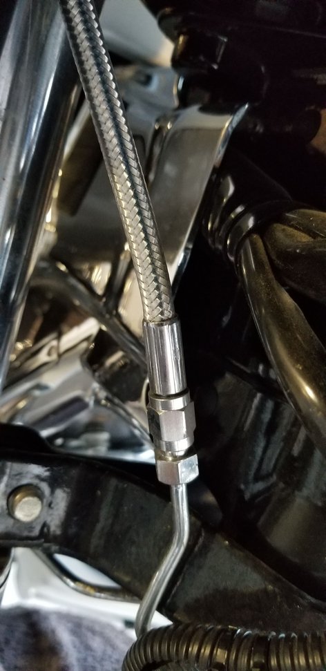

Originally Posted by RKZen
I originally had the H-D braided brake and clutch lines. I recently replaced them with Magnum Shielding lines. They can make them +2" than OEM or whatever length you need. They have SS finish, as well a a chrome finish called Sterling Chromite and chrome fittings.
I 2nd this post, I used Magnum Shielding when I put new bars on my 04 fatboy and will use them again when I do my bars on the 14 SGS. great company to work with,
Edit: Here is mine from magnum shielding, this is on my 04 fatboy and I just did the bars last year.
