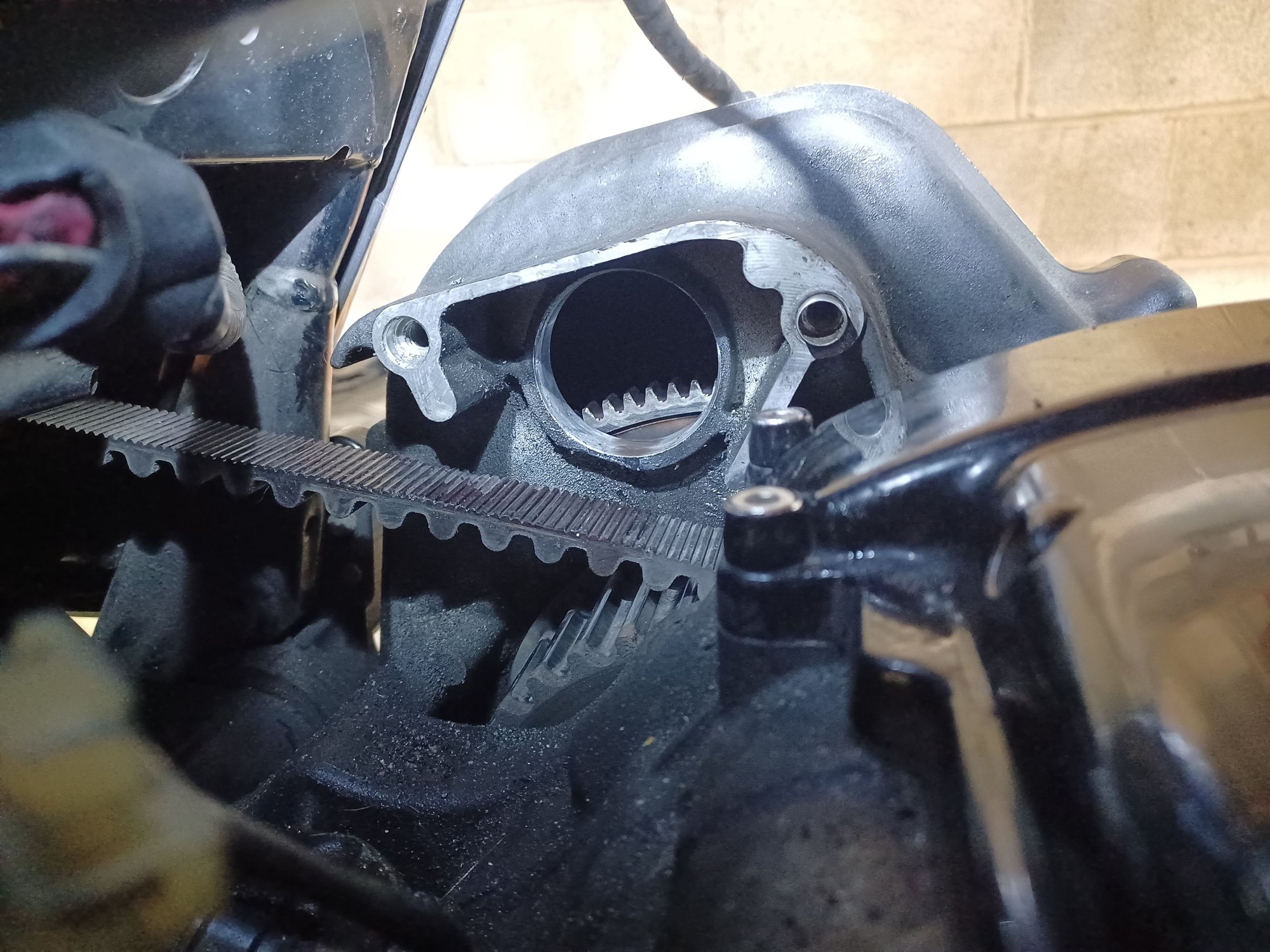

Appreciate the input. Pulled the starter this morning, figured I'd start with that. The back of the primary case is nice and wet. Hard to see in the picture. Not sure what's going on with this starter. Like I said replaced the starter clutch when it leaked originally and fixed it.

Did you clean it up really good after the last "fix"......?
If so, that could be your leak again... but that looks to be pretty old grime in that pic...
Yeah I did. Definitely some old grime there still but the primary case is fresh wet. Weird problem

Well, changed the starter out yesterday. Quite an annoying job ever since changing to a 2-1 exhaust. Anyways, test rode and it would appear I have a dry garage floor! I went with a Terry Component starter and even spoke with one of their techs. This is what he had to say.
"This type of leaking occurs because most brands do not use the correct
clutch and bearings. The 1.5kw (2007-2016) starter needs to have a
clutch shaft with a seal and use a sealed bearing. We use a triple
sealed bearing."
Anyways, hope this will help others with the same issue.
