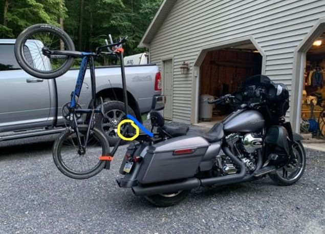

Here is the first trial fit of the new rack I built.

I think this is a pretty cool idea! I am a bit concerned about all the weight being placed on the gusset and aft part of the rack (circled in yellow). I feel that a second gusset from the pole down to the forward part of the rack (blue line) would allow the full rack to distribute the weight. I know this will also take away the storage space of the rack itself, but I would hate to read a follow-up post mentioning how a few hard bumps and a little fatigue stress cause the aft part of the rack to break off.

This is not going to end well long term.

Keep in mind this is a sub 20lb bike and the rack is schedule 40 x 1.25 stainless pipe. There is more flex in the tour pack mount then in the actual rack. If anything would bend or break it will be the tourpack mount.
