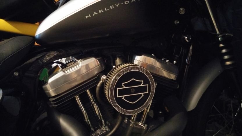

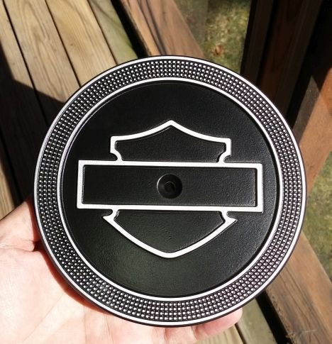

My previous bike (Nightster) was black denim and I used the JD Blitz Black along with a matte clear to paint an air cleaner cover that my friend machined for me. It turned out to be a very good match.
