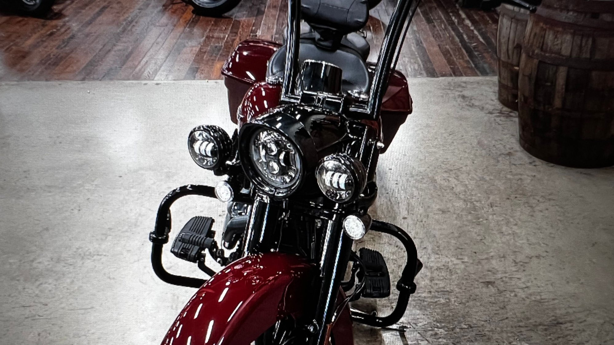

1. I really like the look of RKS with AUX lights (or stock RK look) but I coudnt find aux light in catalog while I see some RKS have it. How to pull this upgrade?

As far as the aux lights, it's the same as what is on the Ultra Limited. Someone can chime in but only thing you'll need are the bushings for the windshield, or if you decide to get a detachable batwing later.

As far as USB, you have an ACC plug behind the left side cover. I think the RKS has has two toggle switches behind the nacelle, one for the aux lights and the other the ACC for that plug. At least the RK standard has those. I have them on my '13 King, but the ACC plug is under the seat. It's a deutsch plug and I just run a USB power port from the plug to the bars to power my phone and GPS.
