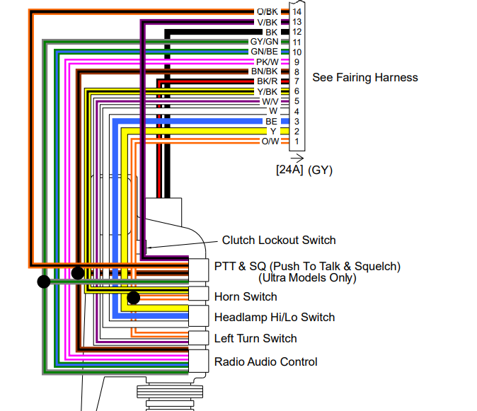

i have a 12 electra.. changed out grips and suddenly no left directional.. everything else on switch pack works but directional...
lights flash when turned off, dont think its the bulb? all wires seem to be connected..

Go back to where you were when things changed. Make triple sure there are no pinched / loose wires in the left switch pack.

Everything was working fine before grip swap? Look closer as it doesn't take much to crimp/pinch a wire...seems too coincidental to be a bulb.

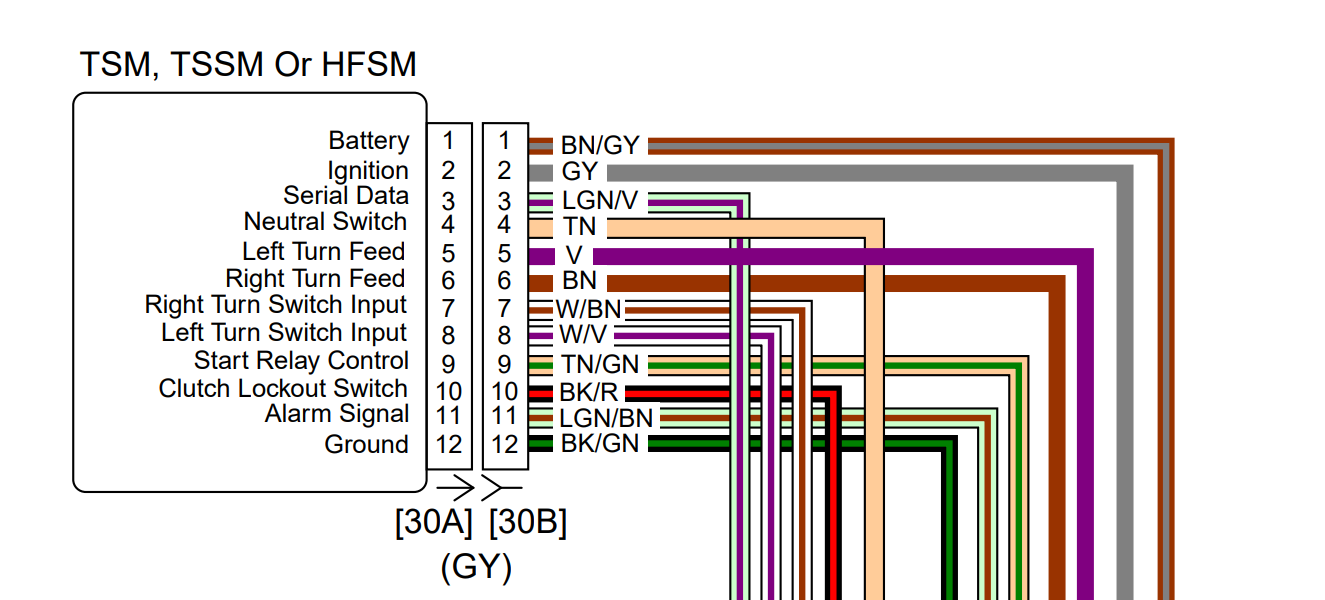

Disconnect the TSSM and see if you have 12V on W/V when you push the turn signal switch.
