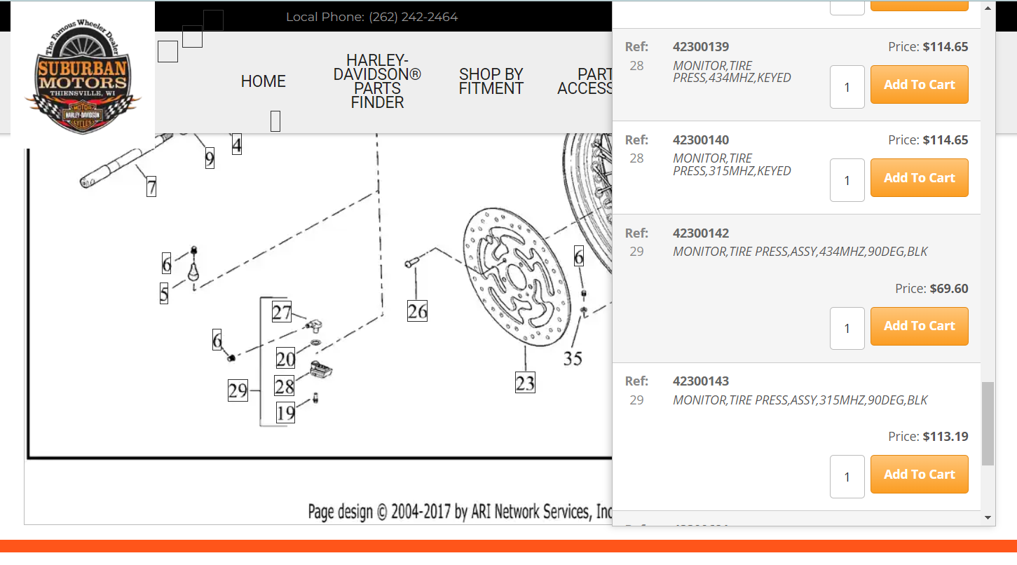

you can absolutely replace them individually. here is the pricing on your bike. not sure why the one is so much cheaper than the other. the ones on my bike are 434mhz.
second the poster above who said have the dealer fix it under warranty. shouldn't be going out already. but, i would try a different tire pressure gauge and up the pressure a couple of pounds. i run 42 rear, 38 front.
