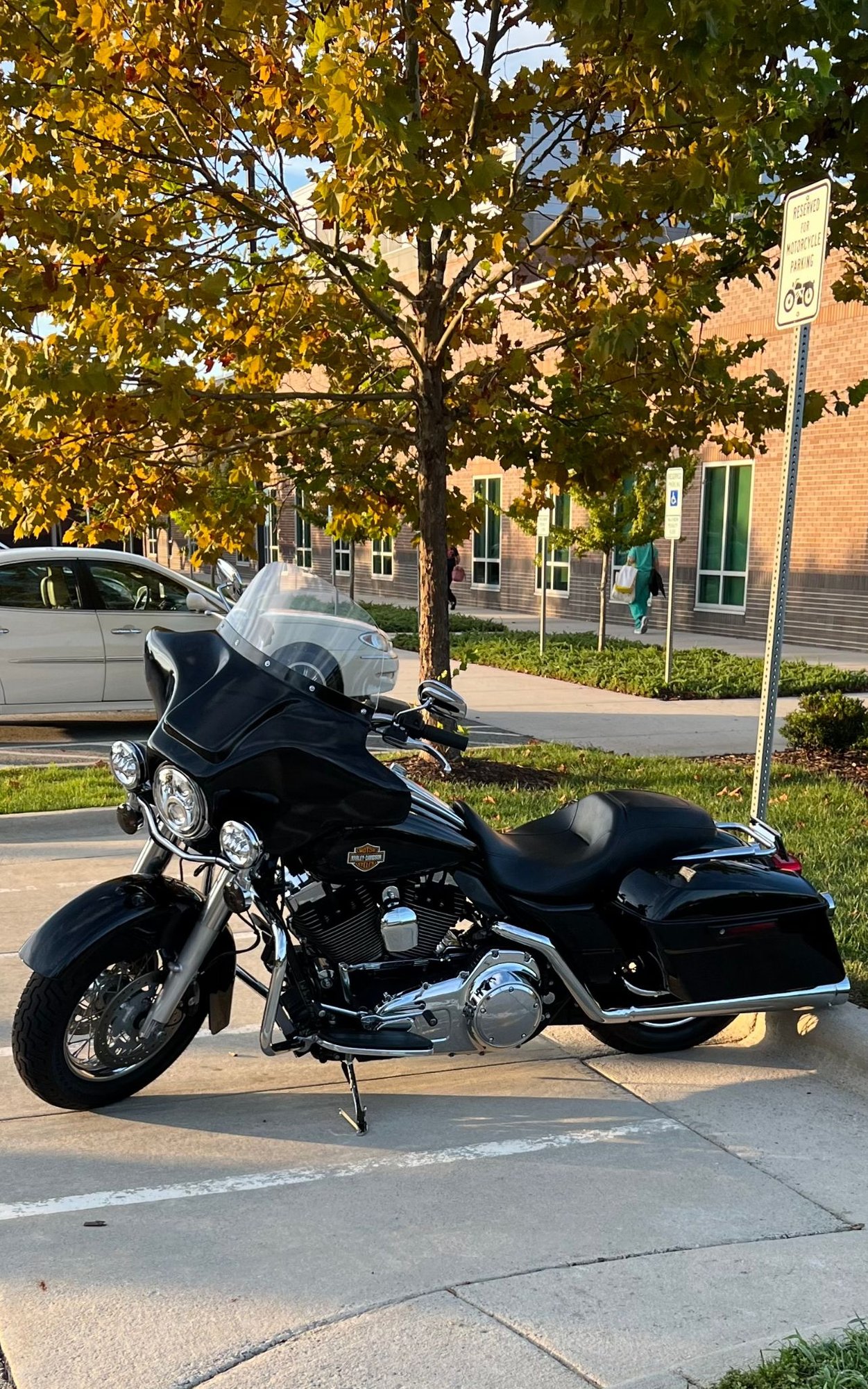

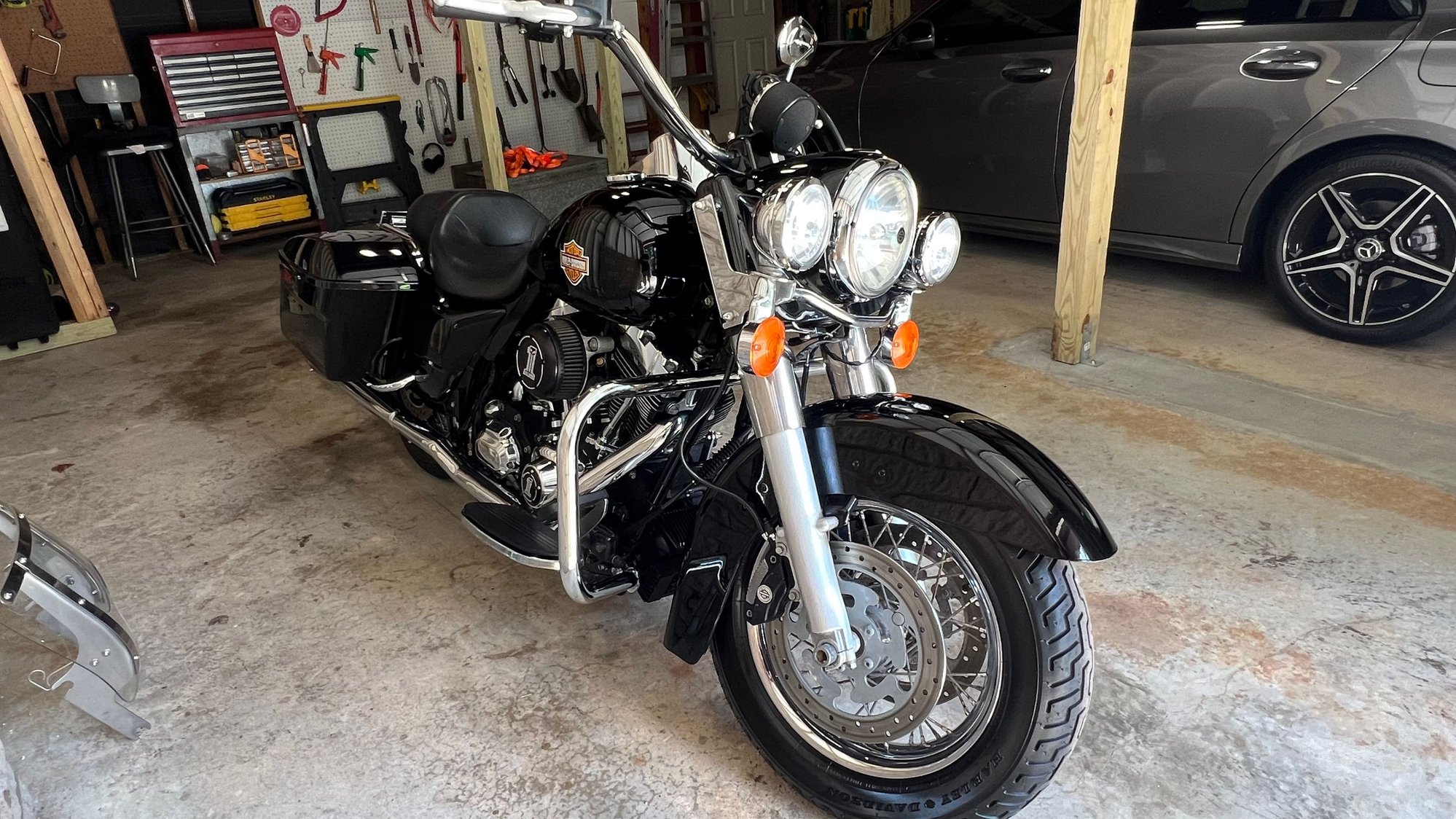

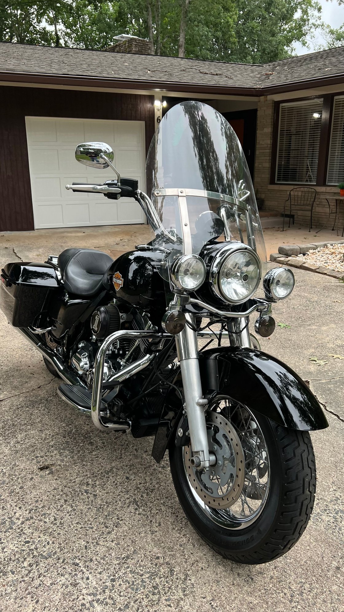

ok so I have 2008 Road King Police when I got It didn't have a windshield, I rode it and it was windy as hell on the hwy, So I got a windshield and its Awesome, but then I wanted music so I got a Batwing and installed it, now there is a lot more vibration with the batwing than with the windshield. ( Hwy speed ) maybe I installed the batwing wrong?

The batwing fairing is more weight on the front forks, so you may feel that weight over the windshield... but I don't believe it should cause more "vibration"...
I have an '03 Heritage with a windshield and a '16 bagger with a Batwing fairing. They are of course different frames, but while I notice the difference in air flow when I switch between bikes, I do not feel any extra vibration with the batwing....
I'm assuming you installed an aftermarket batwing fairing...? If true, my guess is either an installation/mounting issue, or a fairing design issue...
Good luck with finding the source of that vibration.... Report back what you find...
yes I installed it my self it actually came out of another Road King. Thank you for your input and advise.

Not saying that there’s not an issue, but it just might feel “different” from what you’ve experienced to date. Check out the hardware anyway. When I installed fairing lowers on my EGStandard, there was and is a noticeable increase in wind buffeting at higher speeds. Yeah I got some with the batwing, but something was different…new. I could only attribute that “new” feel to those “new” lowers at Highway speeds. At least I believe that’s what Einstein would tell me anyway.
BTW…your bike looks sharp with the full fairing.

You need fork fangs......and play with the angle of the fairing (a couple degrees matter), if the one you got is adjustable.
That's what I had to do with mine.
