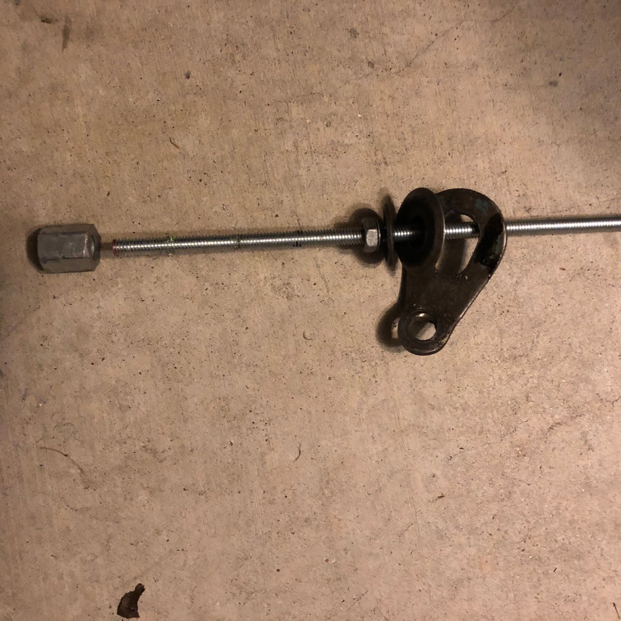

Thanks. I installed chrome lowers last year and struggled getting the top cap started on my 2018 RG. I've done earlier models, like my 2013 RG and was easily able to start the cap by hand.
I ended up using a piece of all thread with a few larger washers in the upper tree to push the cap down enough to start it with the tube clamped in the lower tree only. In the second picture below the long nut fit in the top cap providing a way to turn it to get it started, holding things in place as I tightened the top nut on the all thread to push the cap down. It was crude but it worked. I was hoping there was an easier way, but I was not able to get the top nut started by hand.
Paul

the op upgraded his suspension to pro action. Their springs are shorter but stiffer and they have you cut the tubes even with the top of the fork, so you only have to compress the springs 1/4inch or so to get them started. It is way easier than trying to stuff the stock parts back in.
