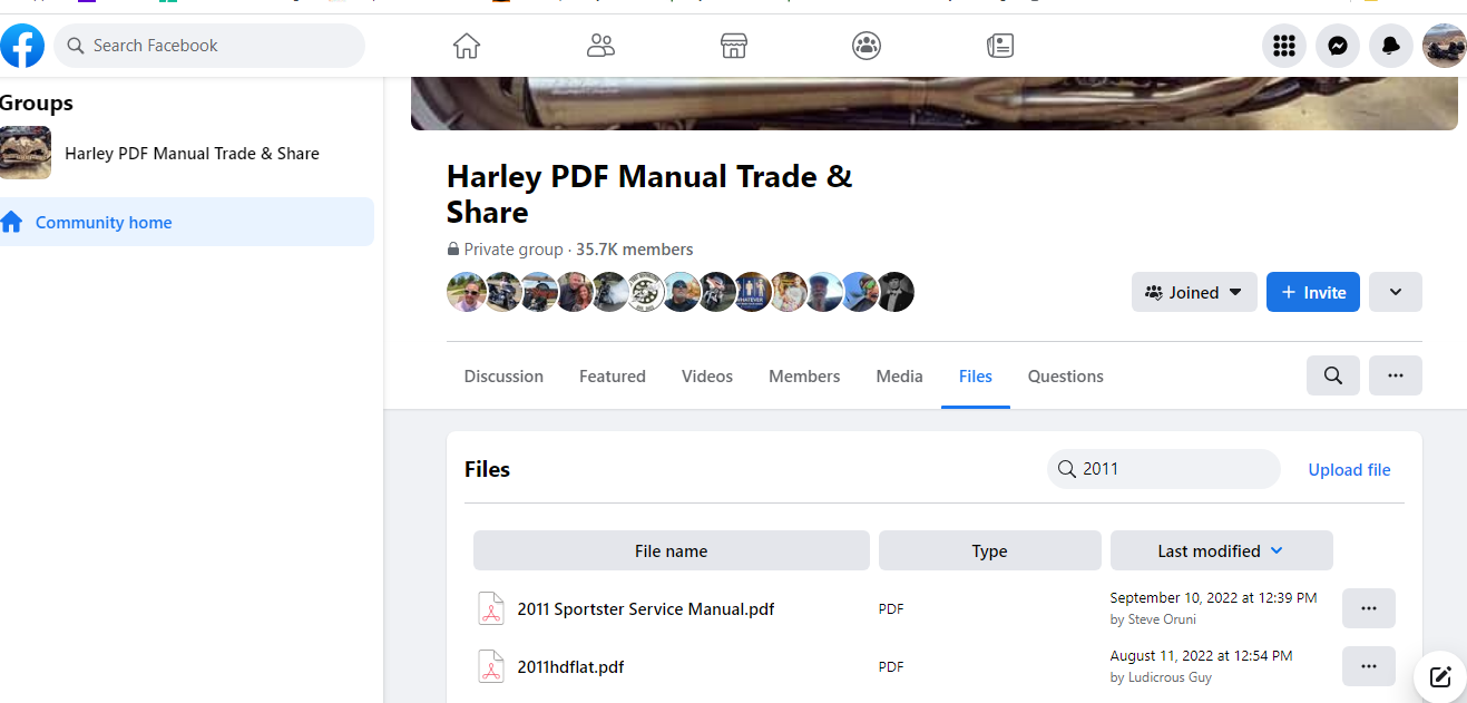

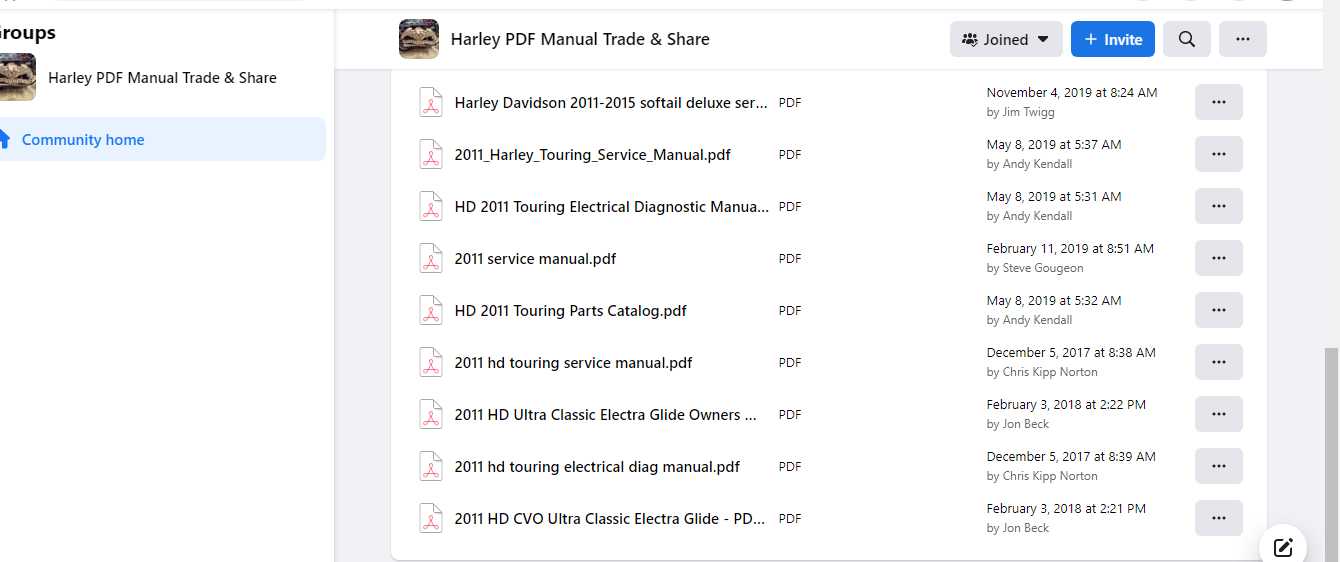

If you don't have the Electrical Diagnostic Manual:
Go to this Facebook site and ask to join.
Then click on Files and type 2011 into the search bar
Look for the Electrical Diagnostics Manual. Third one down in the picture. You might want to look for the service manual too if you don't have one.
Download it to your hard drive.
Look at section six and see if there are any checks you can do. They mention using harness connectors with a Digi Tech but looking at the schematics you can find the wires they are checking.
