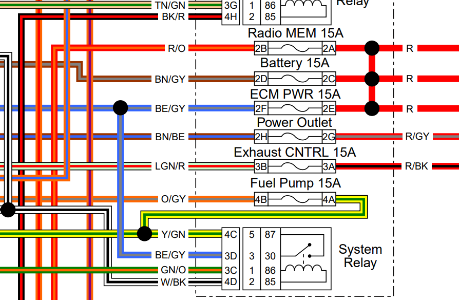

The system relay energizes when you turn ignition on then off/run switch to run. The W/BK wire comes from the off/run switch. The GN/O wire goes to the ECM and provides a ground to the relay coil for 3 seconds then shuts off if it doesn't see a signal from the CKP that the engine is rotating. When the relay "makes" the yellow / green wire has 12V on it and the fuel pump runs, fuel injectors and coils have power.
Put a meter on the system relay side of the fuel pump fuse and turn the kill switch to run, you should see 12V for 3 second. Now hit the starter, do you see 12V again?
Between 1and 2 there is 0 volt ignition on and cranking still 0
Correction measured with relay in and showed 12v between yellow/g and O/G

1 = 3C GN/O
2 = 4c Y/GN
3 = 4D W/BK
4 = 3D BE/GY
Measure voltage to ground not wire to wire.
Pull the relay and turn the Ign on and run switch to run. BK/W and BE/GY should have 12V to ground.
Pull the fuse just left of #2, should be the fuel pump fuse, and see if it's blown. If not reinstall the fuse and relay then ground the black lead, touch the red lead to the little metallic spot on the top of the fuse next to the 5 in 15, crank the engine and see if you get 12V.
