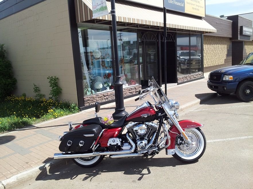

My 2012 Road King, since sold. I'm 5'10" on a good day, and these bars were incredibly comfortable. And wicked cool to boot. 14" Wild1s
My advice is you should optimize for comfort. Buy the most comfortable bars, and whatever is required as well, including cables. Why keep those hideous stock garden hoses anyway?
