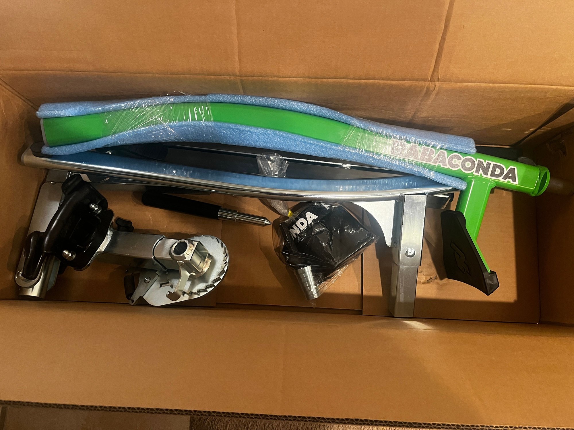

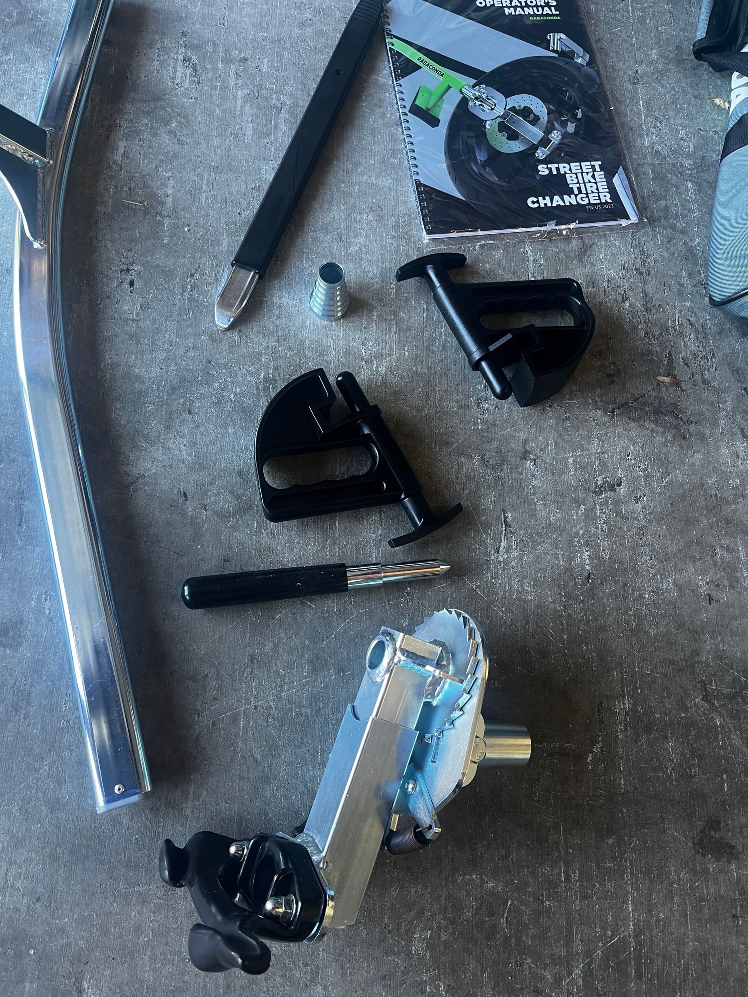

I opened the box, and the boxes inside the box. This is really well made, good welds, finish detail, and is quite heavy duty. I'll make some time tomorrow to put it together and post a couple pics for you guys.

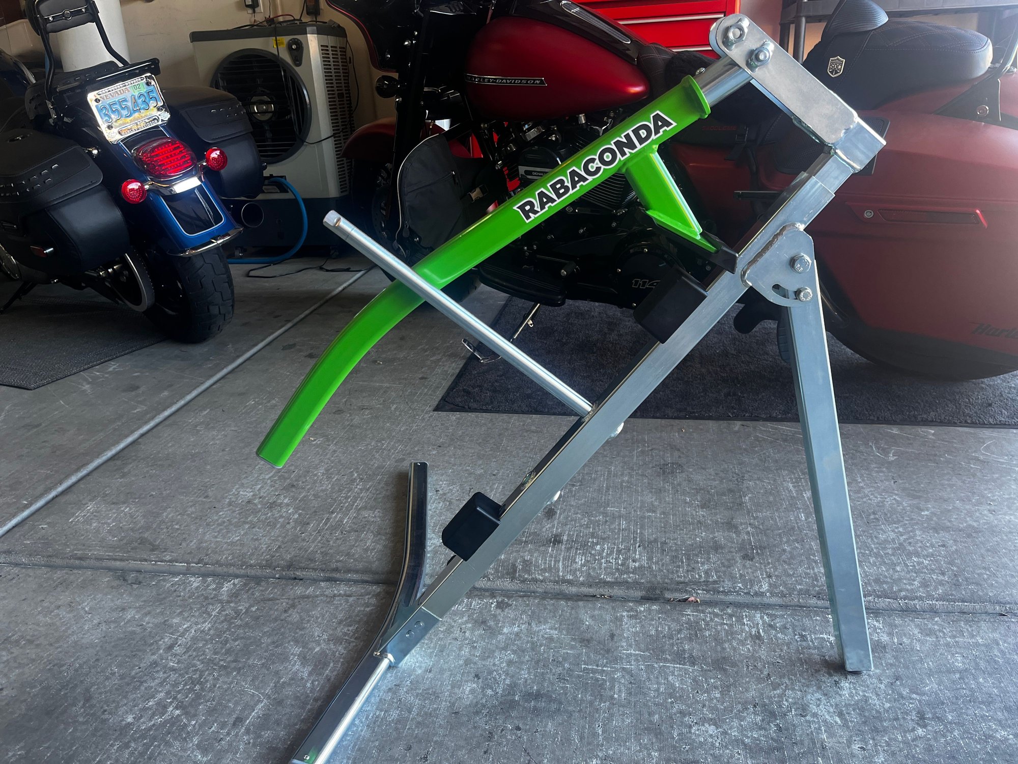

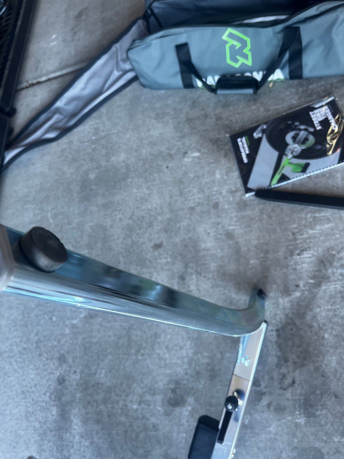

Not much more to see or say, but this thing is beef. Assembled in under 5 minutes.
The bottom of the stand has rubber feet to hold it in place.

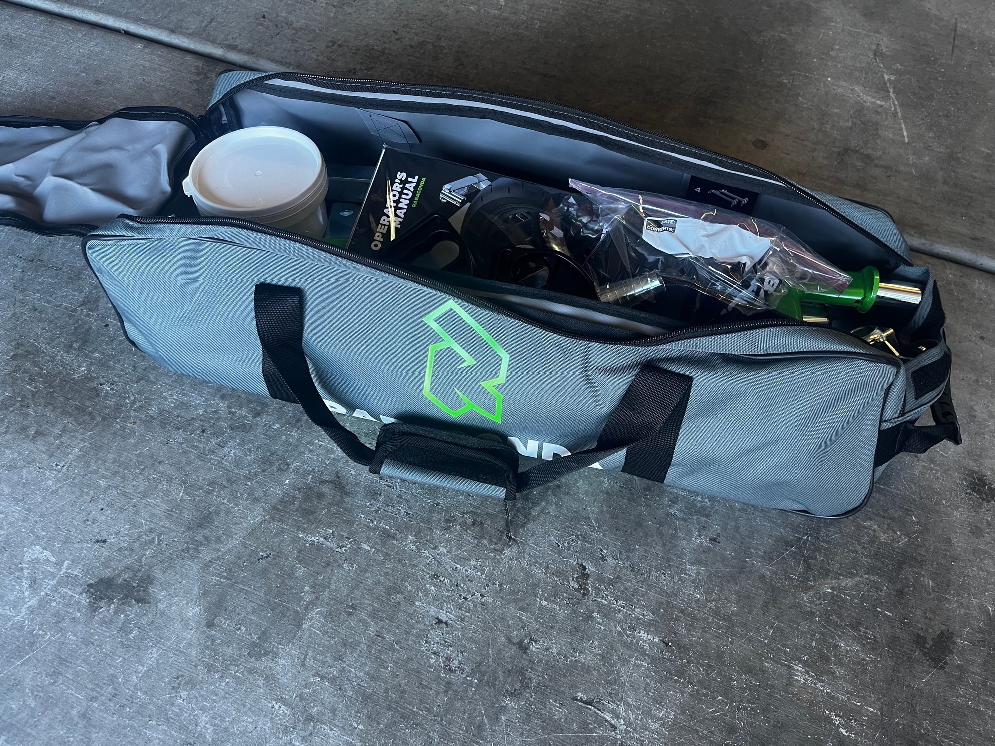

Even the storage bag is thick and heavy duty.

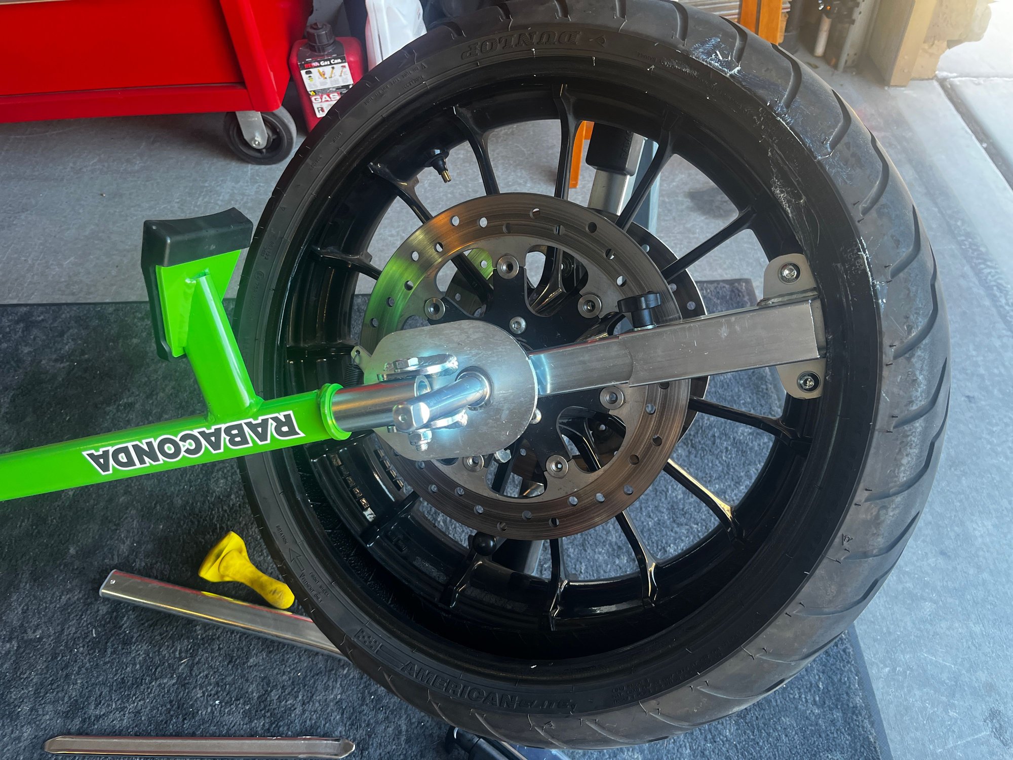

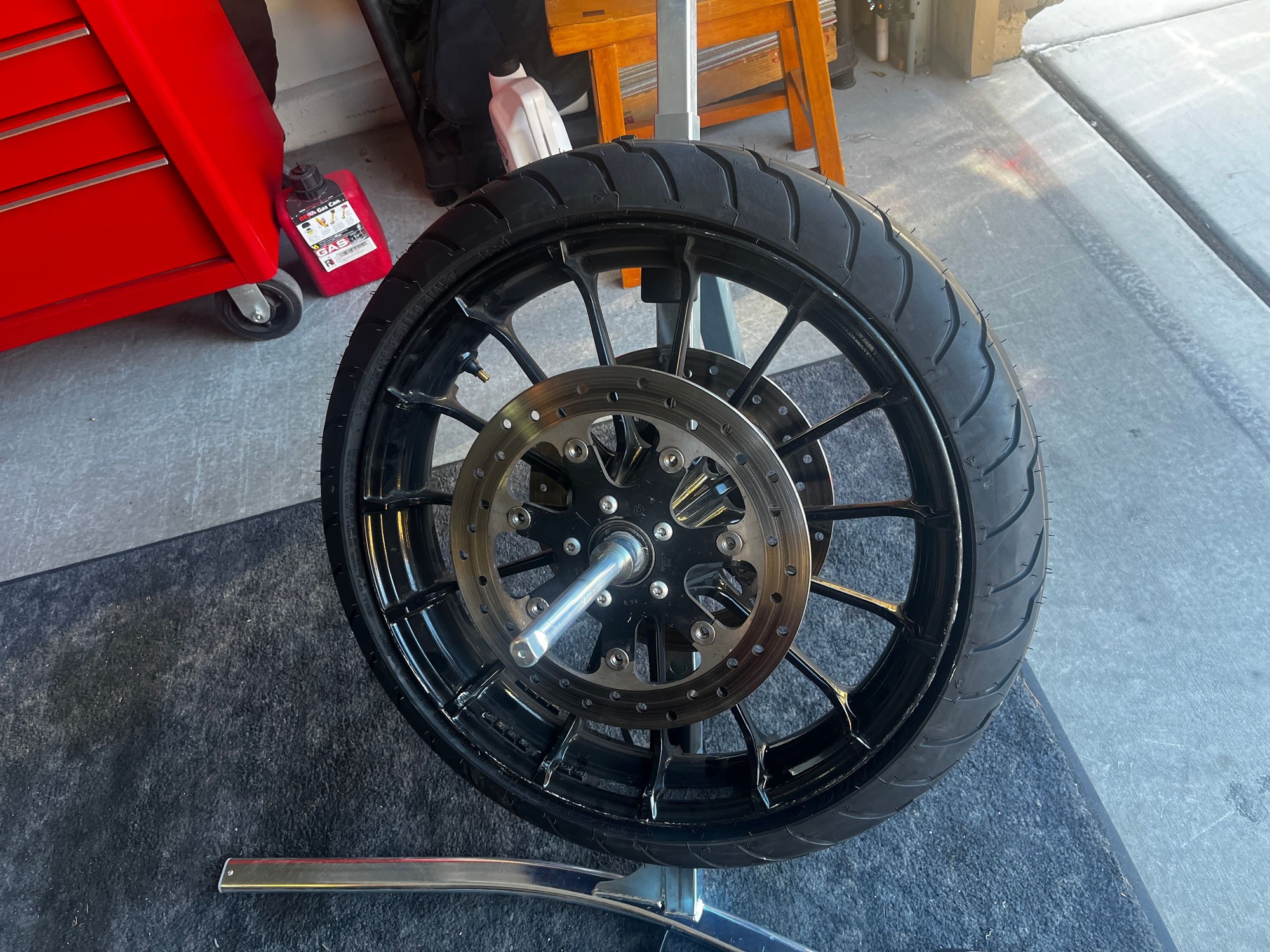

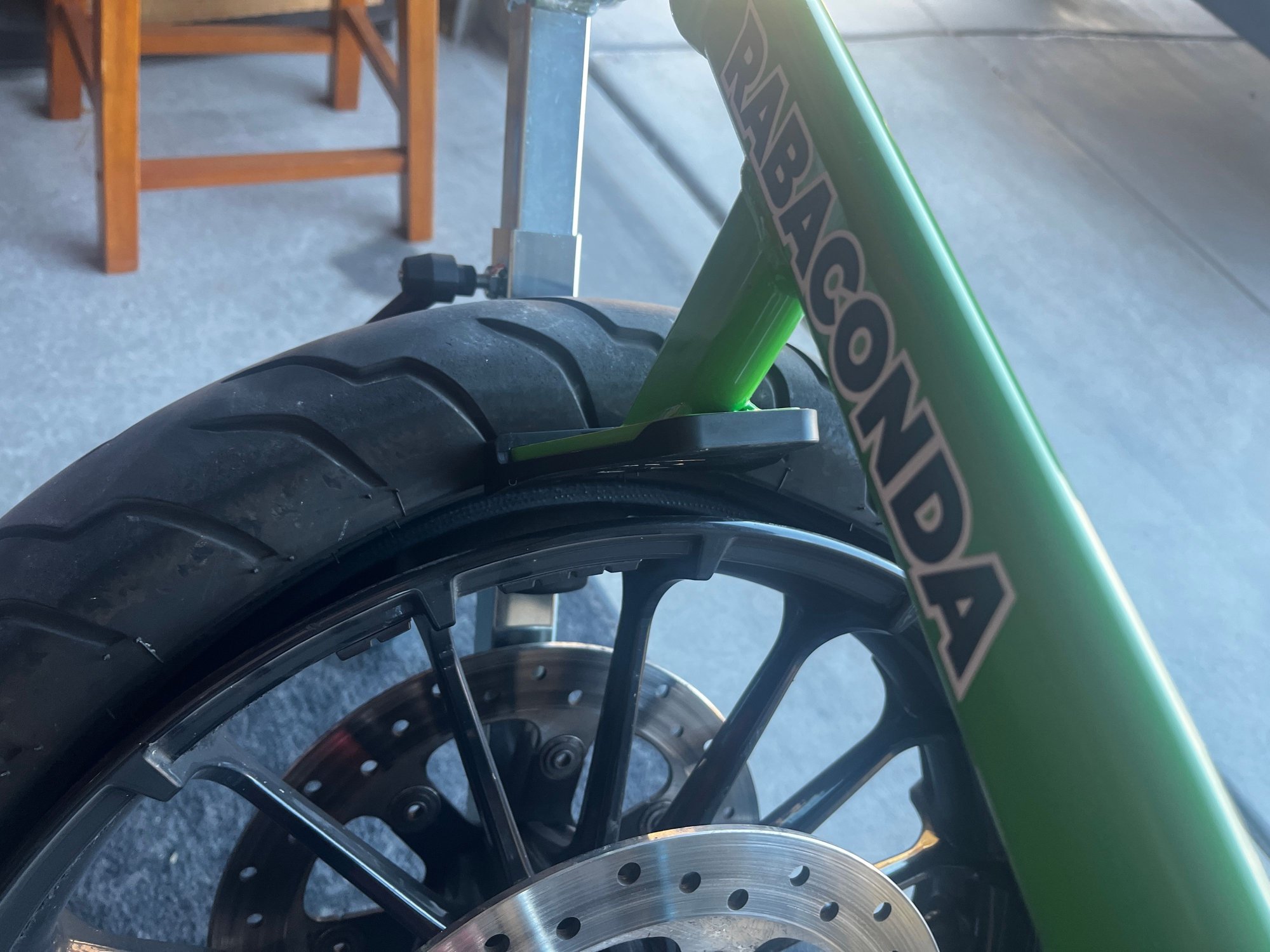

I put it together and mounted my front tire/wheel to it, let out the air, and broke the bead on both sides. I literally said holy **** that was easy out loud. On to removing the tire. I struggled with this for about a half hour and decided to step away before I broke something. I went and had tacos and thought about what I could be doing wrong. Turns out the bead on the back side had got itself nearly seated again, so I flipped the wheel around an broke the bead again, After that I had the tire off in under 2 minutes. Both beads need to be free of the wheel, and floating in or near the drop channel of the wheel.
Those of you that though a stiff Harley tire would be difficult on this tool can rest easy, it works like a champ once you get the hang of it.
These pics don't really tell a story, but I know how much y'all like pictures.
