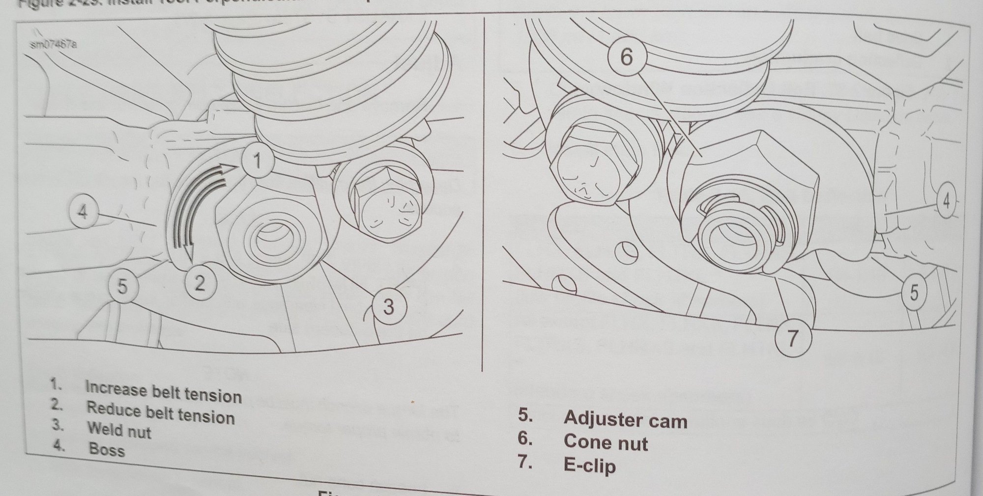

It appears the guy in the video is using a digital caliper to measure the distance between the front edge of the new adjuster plate and the swingarm boss (#4 below). He measures both sides and fine tunes the adjustment to ensure both sides are equal.
Edit, Scott beat me to it as I was typing.
