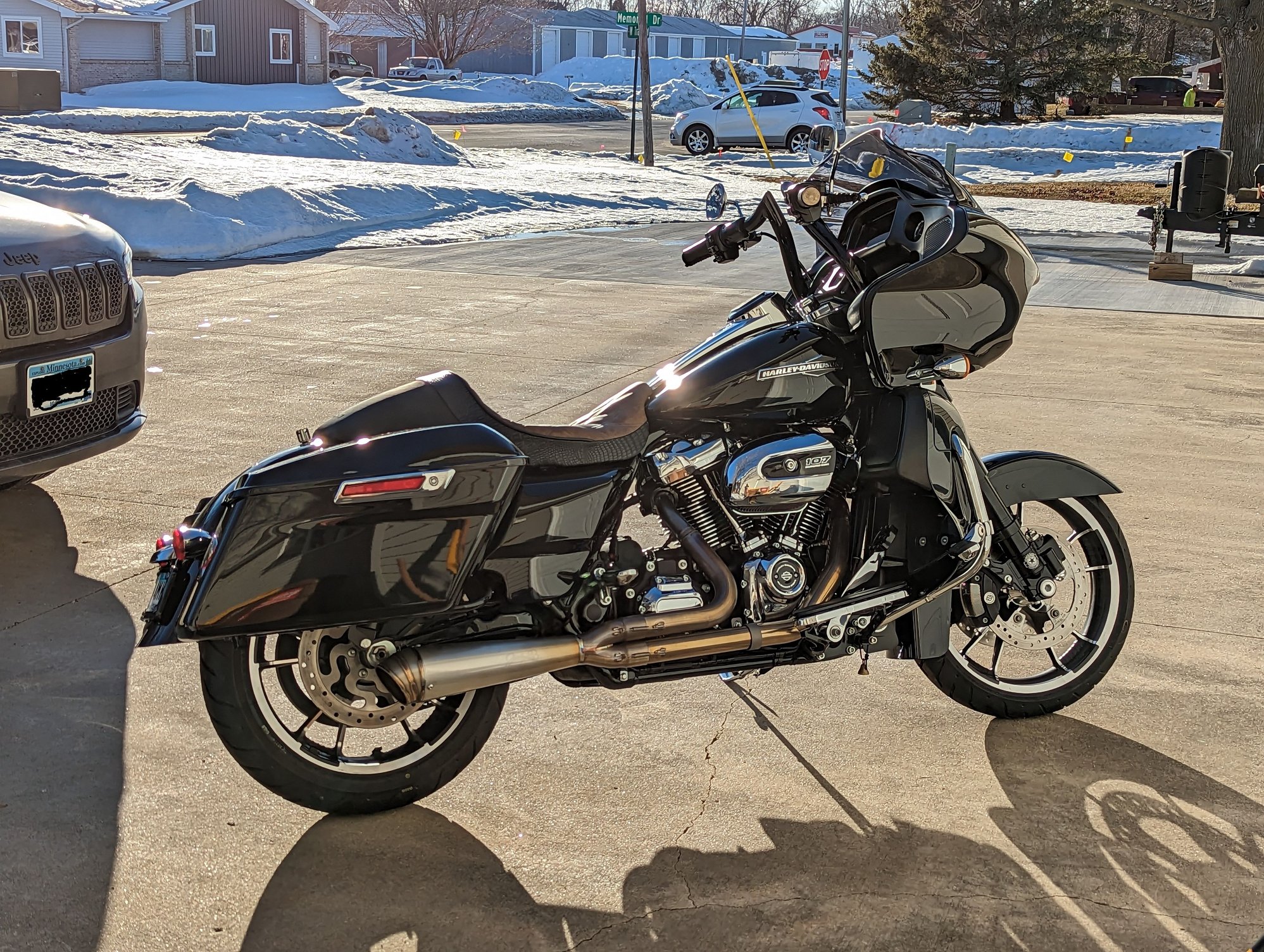

Old Feb 12, 2023 | 07:11 AM
man4mopar's Avatar
man4mopar
Joined: May 2006
Posts: 941
Likes: 27
From:
Roads around here in SE MN finally looked good enough to take a couple short test loops checking things out after all the work. First impressions are very good though extremely limited time and conditions so not ready to give deeper review or thoughts. No issues found which I am excited about. Weather around here might hit 40 degrees this coming week so may get out for 100+ mile ride to learn more.

How is that pipe sounding cruising? Any drone or does it mellow out?
