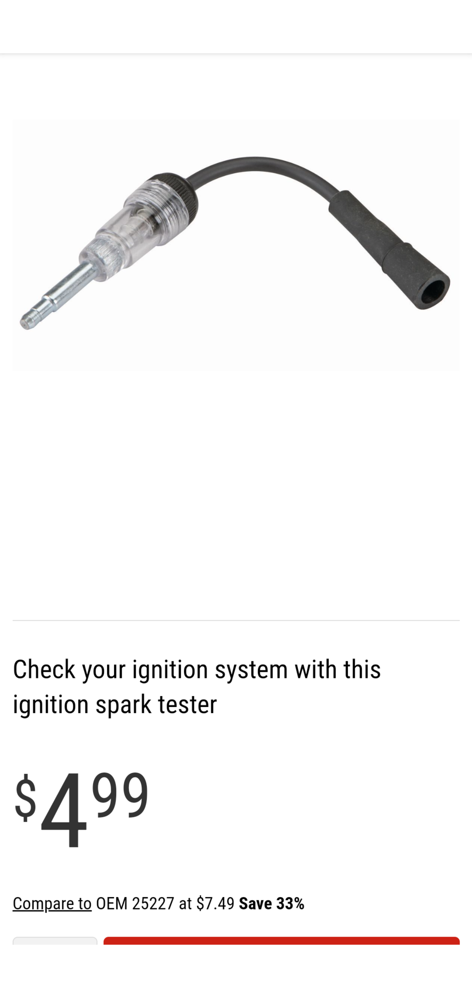

Harbor freight $5. Don't have to remove spark plugs. Since I bought it I haven't shocked myself, throwing a screwdriver I was using across the floor, nor have I ignited that gas air flame thrower shooting out the spark plug hole as I grounded the spark plug to close to the hole.
