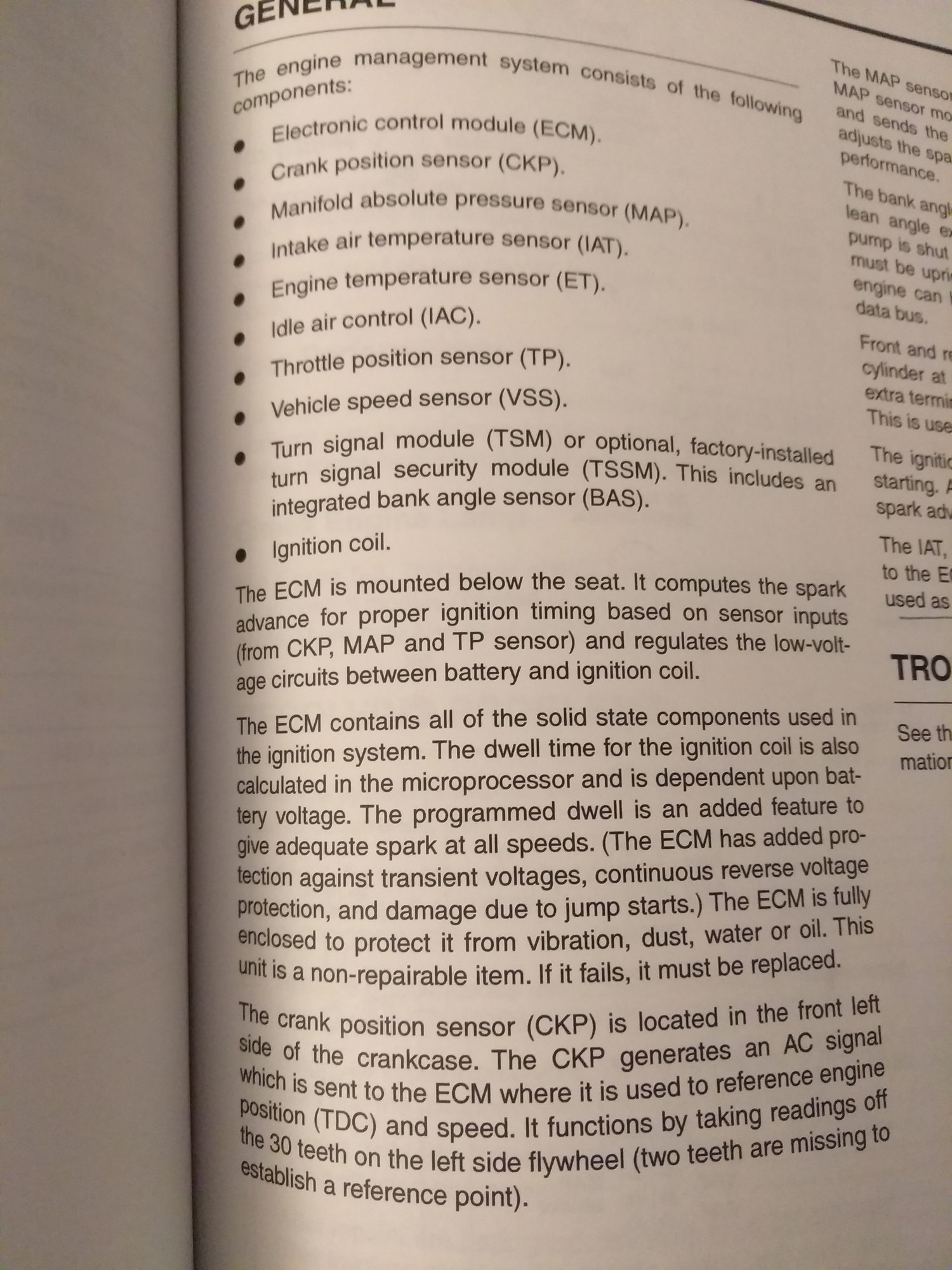

Actually, the 04 has ion sensing or the EFI system. A long while back, there was an electrical engineer on here who said he engineered the TC electronics and said it monitors it in the coil for feed back to the ECM.
I have never checked it myself.
But I have seen many cases on here where it's true
This is what it says. And that's not exactly what you said. It's saying use tester with plugs installed. You can use a third plug as a tester.
Will post the picture shortly. From my 04 Diagnosis manual.
The first poster has not identified if his is EFI or carb.
