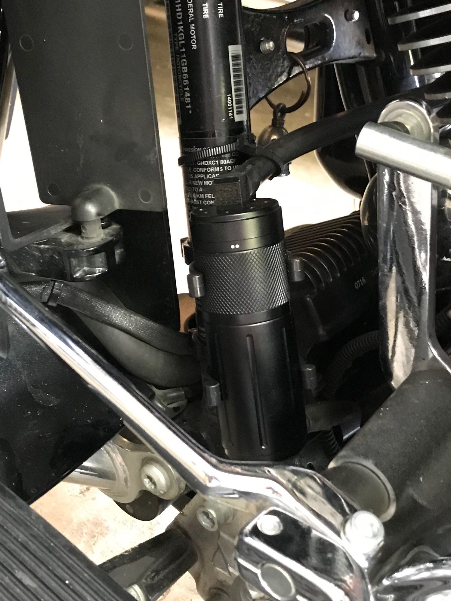

Originally Posted by Ken45
I think for now I will use a home made little catch can in side the 107 air filter housing. The bike has 2,563 miles on it and I do not want anymore oil going into the intake. The oil that was in there easily wiped out with a rag and I really did not like seeing that. May go with a Trask trans cover and breather system at some point? Warranty runs out around mid July so I can not do much until then
Here's my home made one
If you're interested, post 4 in this thread, has links to the canister and clips used... just for ideas.
https://www.roadglide.org/threads/ex.../#post-4929213
