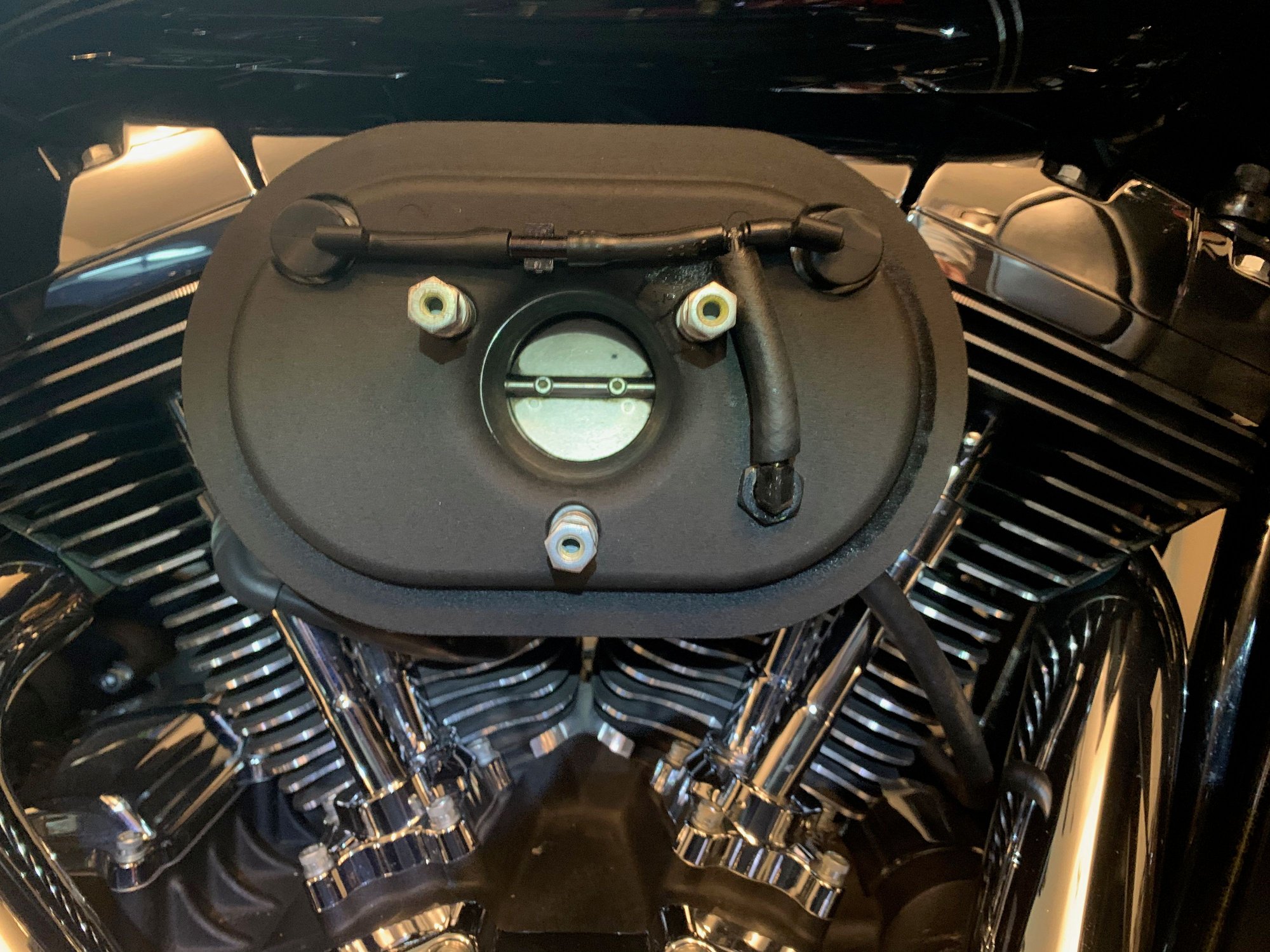

Not on a M8, but I believe this is a similar breather, just for an idea....

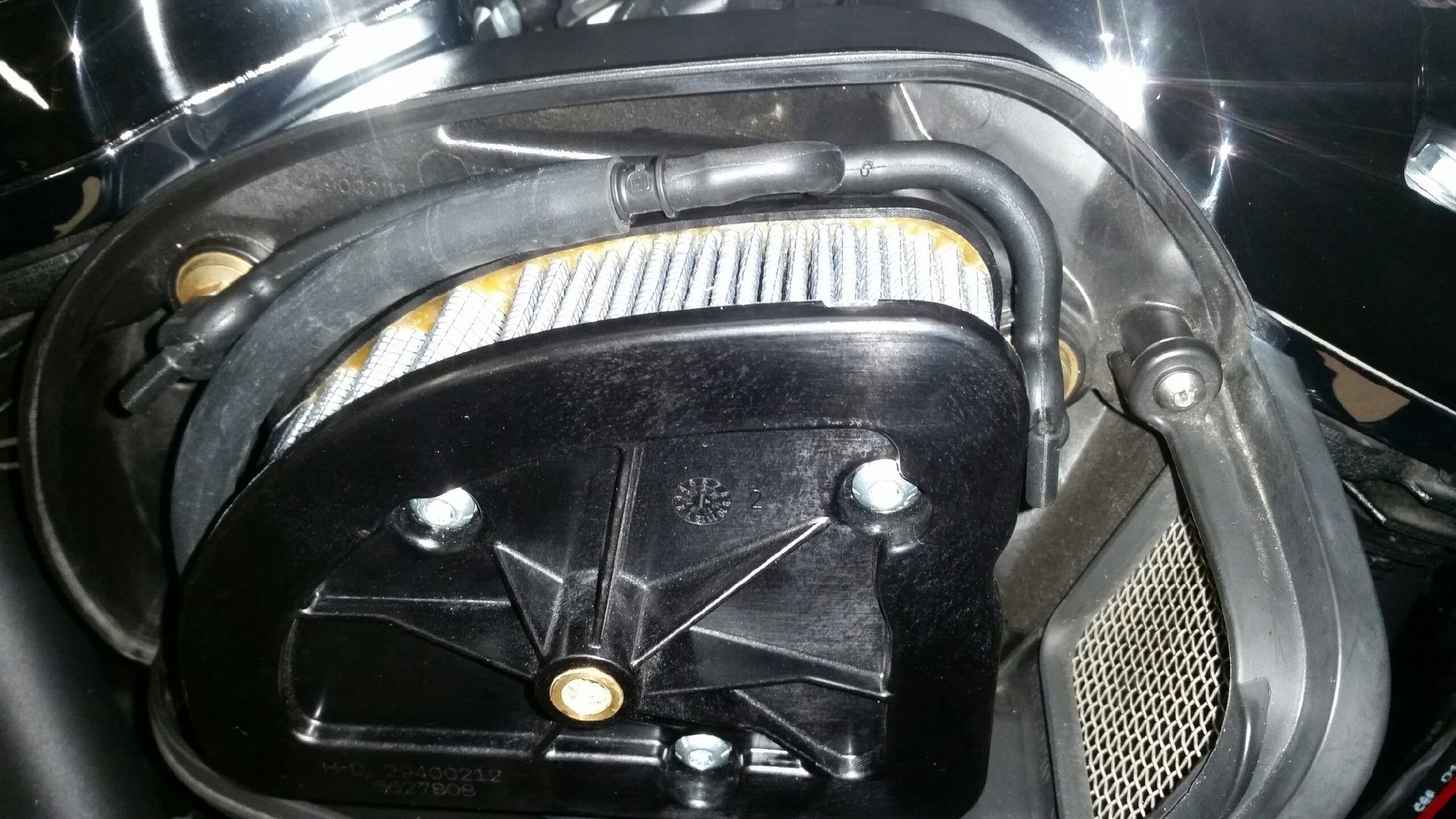

Here's a thread that may have some ideas for you:
Finally did my breather bypass (pics included) - Harley Davidson Forums (hdforums.com)
And the post I just made to that thread addressing your exact question:
I haven't been through the 68 pages of this thread to see all the variations, but if you're running the OEM air cleaner in a late model touring bike air cleaner housing, you can pull the breather tube connection out of the tube in the back of the air cleaner, attach a rubber hose to it, drill a hole in the back of the cleaner housing, and run the hose out and down.
To clarify, each breather bolt has a tube connected to it. The tubes are joined together by a T-fitting, with the third prong of the fitting going into a crooked little tube that goes into a hole in the air cleaner itself (to route the goo to the intake). You pull the third prong of the fitting out of the crooked little tube and attach that to your new hose to be routed out and down. You'll want to remove the crooked little tube from the air filter since it will now allow unfiltered air to enter, and plug the hole (or just plug the tube itself). This costs no more than the cost of the hose, plus an old screw or plug of some kind (make sure it's something that won't get sucked in!).
Writing this at work, so no pics handy, but I can take some if it's not clear.

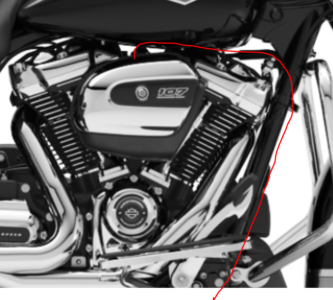

I am thinking about running the hose up and to the front and then down to a can or filter as shown by the red line.. Does any one see a problem in running it this way?
Opinions seem to differ on this, but I note that the tubes inside the filter housing (on mine, anyway), rise before they fall. Whether a larger rise holding more goo would make it back up, I don't know. I haven't seen anything definitive, and I researched this quite a bit before doing mine.
Old Jan 12, 2023 | 02:06 PM
YZR's Avatar
YZR
Joined: Jan 2019
Posts: 3,622
Likes: 2,878
It seems like the hose should always go down, I'm not sure it it will pump the gunk uphill.

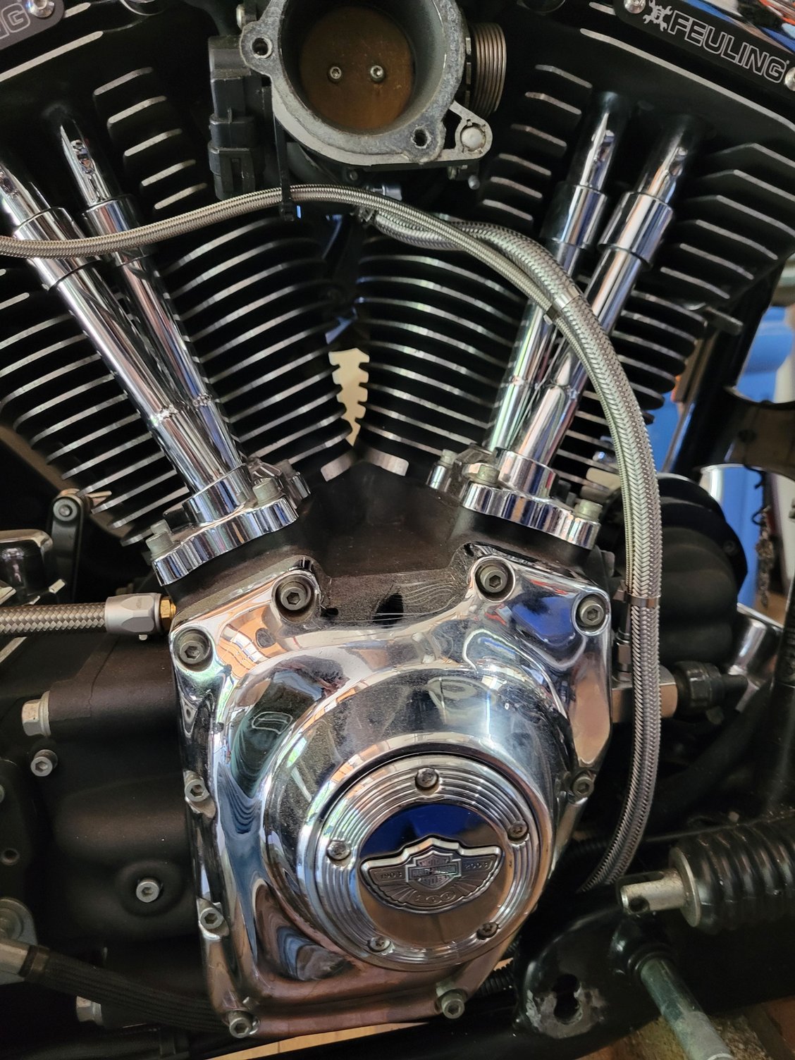

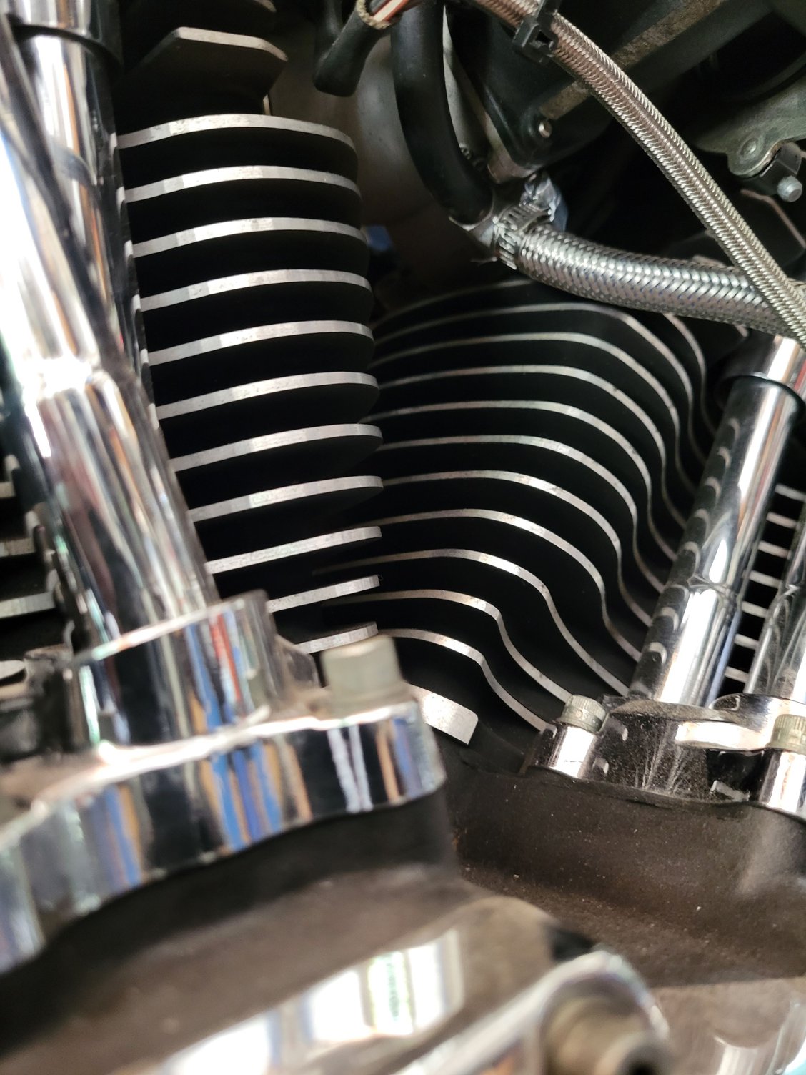

I did it the cheepie design. In the pics, that SS braided line is very inexpensive, plumbing section at Lowes, Ice maker water line.
smaller line is oil pressure they meet up and head our together
The larger line turns under the can cover, runs along the frame, then into a 90 just behind the cross member

That big-ole air cover hides a bunch.
