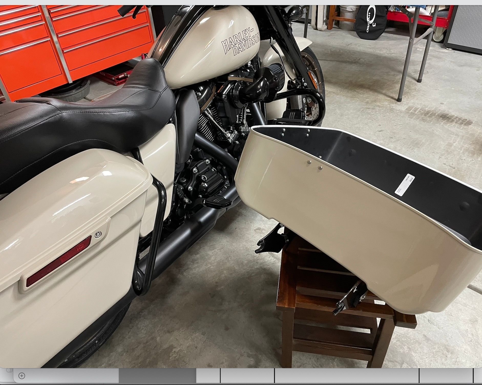

I bought a new 2023 Street Glide ST in White Sand Pearl and I wanted to paint an old Tour Pack to match it. I did my best to find the color code but I never did. I did, however, find the ColorRite online store that had it. I ordered a pint of the base coat and a pint of the pearl coat. It cost $334! I shot it over a base of white urethane primer. I did two coats of base and two coats of pearl. I finished it off with two coats of Nason brand 2k clear coat. Unfortunately, it wasn't a good match! The ColorRite product resulted in a darker color.
To be fair, there are many variables when painting. I called ColorRite to see if they could help and they offered me a 10% discount on another purchase. No thanks.
Next time I am going to take a piece of the bodywork to my local autobody paint store and have them custom-match it for me. Has anyone had a similar experience? Has anyone found the PPG paint code (or formula) for White Sand Pearl?
Bad match I'm afraid.

Honestly I think you may be the only one to notice.....don't sweat the small stuff. Lighting/shading...it's pretty close. You spent the money now just ride.

I totally agree especially with white sand pearl my 22 fat bob didnt look the same between the tank and the rear fender so I am sure it wont show that much

I am a painter and 3 stage pearl is a bitch to match. I describe it as "it is something you have to touch and feel but you cant touch it or feel it"'

I had the same issue with Black Quartz. Colorite wasn't even close so I ended up pulling my wallet out for $400+ of the HD stuff... The paint was more than I spent on the bags that needed to be painted... crazy.
Good news is it came out perfect.

Same. And after a few years in the sun, they will probably match just fine.
Those who do this for a living are likely matching things manually.
