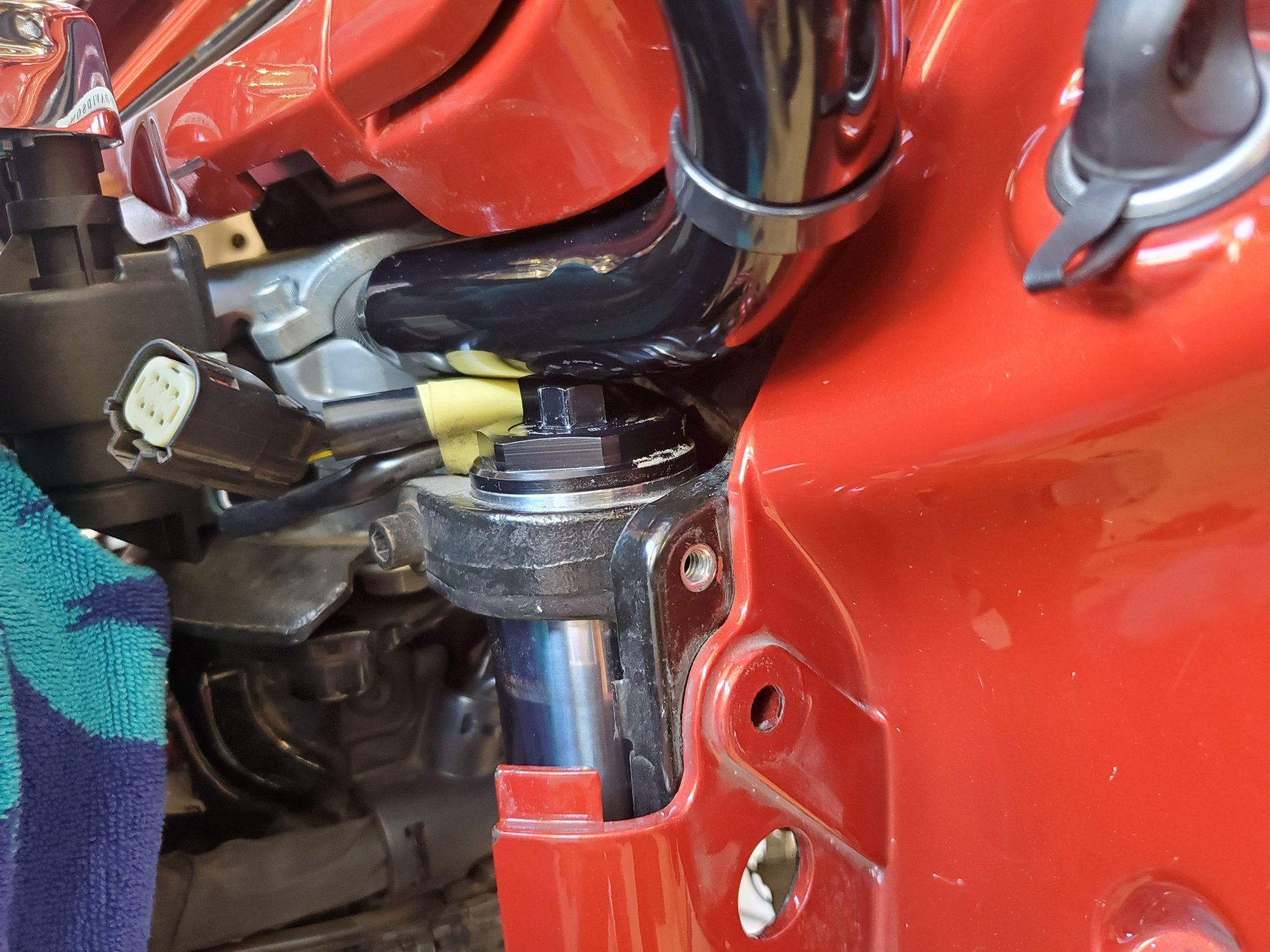

That's like the one I bought as well and also use my air ratchet to run it up and down. I feel better with the wider platform but would think the narrow one would be fine too. The narrow one might give you better access to drain plugs if you were inclined to do oil changes with the bike on there. I also used mine to lower the front forks, with wheel still attached, out of the triple tree JUST enough to get to the adjustment screws on my Ohlins Cartridges because of how/where they're mounted. Made that job a LOT easier!

Not to hijack, but good to see that MotoJockey is one also don't pull the ign switch out to get the cover off to access the inards there. Hard to believe some folks think they do.

Depends on the year of the bike.
