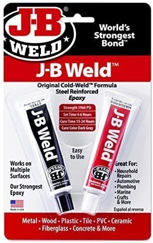

Lots of different JB weld epoxy… is there one that’s better for the plastic to aluminum scenario we’re talking about?
Old Feb 8, 2023 | 07:02 PM
Tired's Avatar
Tired
Joined: May 2010
Posts: 3,599
Likes: 5,175
From: SWMO
I used the original.
