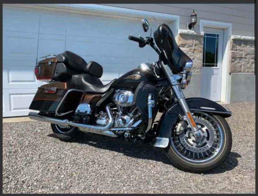

Hello, my name is Chris. Thanks for taking the time to read my thread. I recently purchased a 2013 Ultra Limited anniversary edition with 14000 miles from the original owner. Bike is mostly stock except for some cosmetic items, SE mufflers and air cleaner. Previous owner believes stage 1 download was performed at the dealer but unless they did it free of charge I don’t see any documentation supporting that. I plan on leaving the engine stock until it needs work, which hopefully won’t be in the near future. I think I will be looking to get rid of the converter to reduce heat, probably by gutting the stock pipe. I would like to stay away from a tuner at this time, but the “vieds” seem like a viable option for me to riches up the fuel mixture in hopes of reducing engine temperatures and increasing longevity. Do you guys agree or disagree with this plan?
One thing that came up when researching this model was high incidences of ABS valve body failure causing loss of brakes or brakes locking up. Neither of these are things I wish to experience. I plan on thoroughly flushing the brake fluid. Should I be concerned after that, or is the failure rate low and I just stumbled down a rabbit hole of BS on the internet?
Thanks for any advice

Welcome. It looks like a well taken care of machine l liked the Root Beer color..I have a gutted header pipe on my 012 Ultra and a K & N air filter and that's about it for mods. The local dealer put it on their diagnostic tool and it ran fine. The heat on your right leg is vastly reduced. I removed the heat deflectors from the frame and open the lower vents to let more air circulate. Bike runs great. Ride it and enjoy it.
