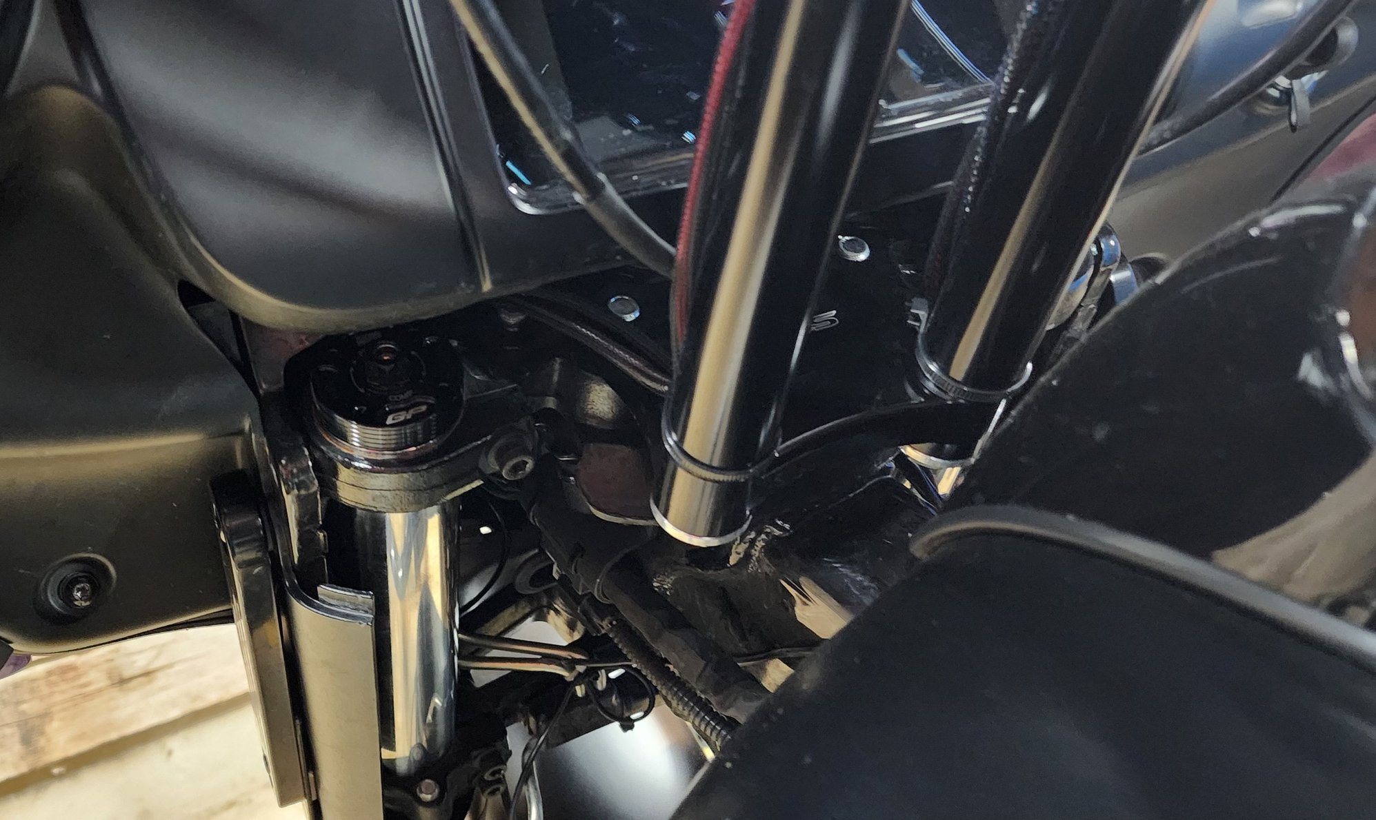

Originally Posted by armacc
What the heck are those non-perpendicular bores through the trees doing? Adding some rake to the front end???
Those are raked trees which Decreases "Trail" opposed to adding more Rake in the Neck which Increases "Trail"
Btw there are some other HD models that use a Negative rake tree (i.e. the tubes angle the other way within the Tree)

Originally Posted by scott_0
here you go!
Thanks!!!! That’s exactly what I went by. I went through and redid everything last night. Just to make sure it was correct. I’m just glad to see they’re supposed to be at a slight angle. I’ve always thought they were supposed to be level all the way around! Thanks again for the service manual pages.

Well looks like you have your answer. The top of the tubes are tapered, yes. 100% normal. And look that you have them in the tree at the same place I do, as per the manual. But, mine stick up a touch higher than yours. There's a shop here that likes to push them even higher, saying it makes the front feel more solid. I don't know about all that, I like to keep it in spec and adjust the bearings like the manual says to.
