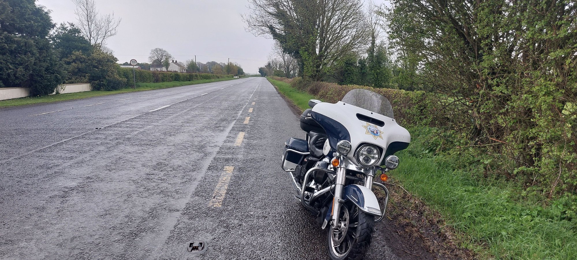

17 Electra Glide FLHTP
I took off my lower fairings and i now get turbulence, interesting. When cruising at 80 there is a vertical vortex of air pushing up just in front of my knee. It's on both sides about the size of my hand.
if I hold my hand there it is pushing it up even if I move my leg away its still there. Its just in that area. strange alright do others get that with the batwing and no lowers?
​​Anyway I will be putting the lowers back on once I have colour matched them.
