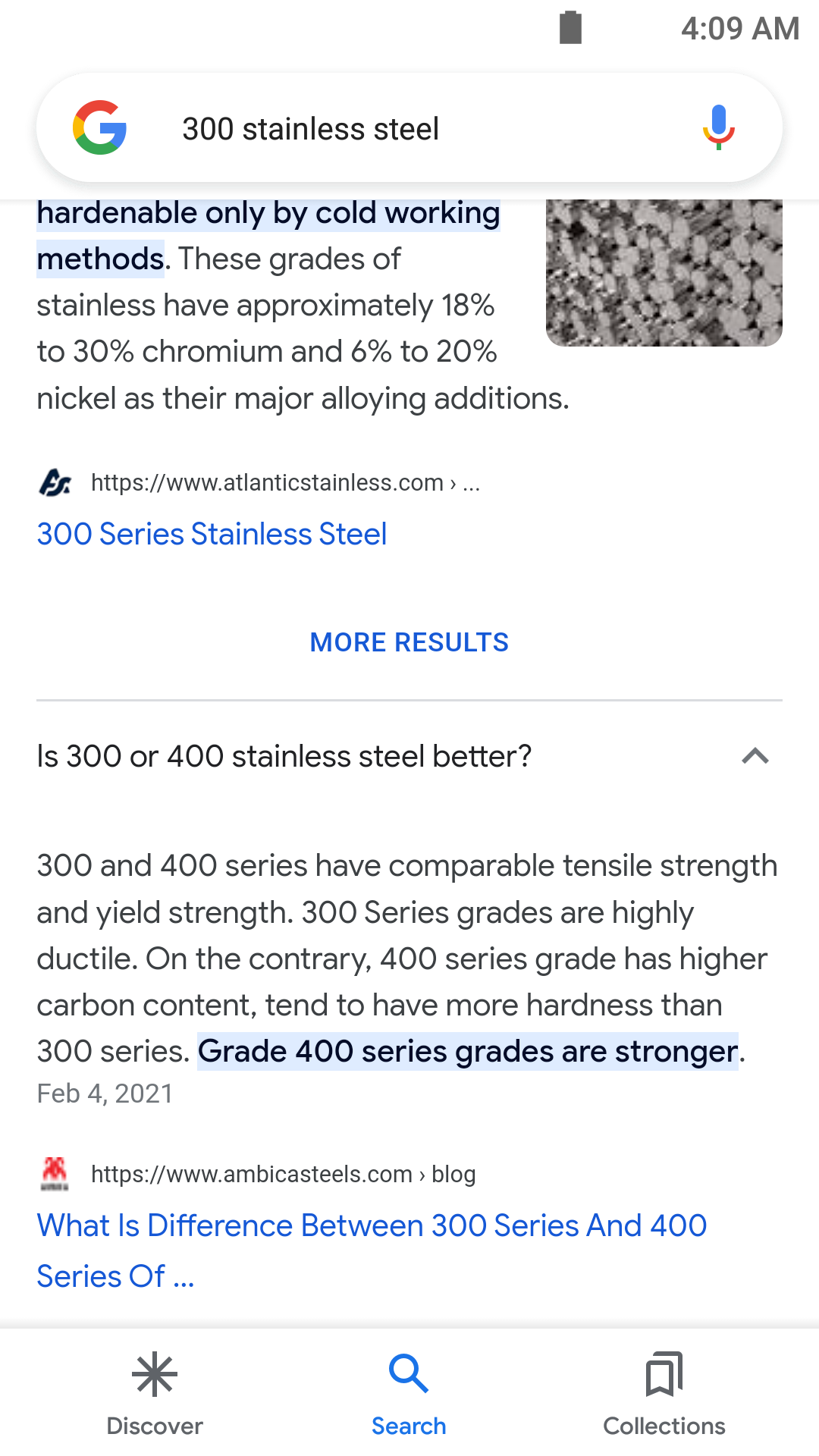

Originally Posted by Jackie Paper
That's 400 series stainless. Has carbon in it. What most cheap grade SS fasteners are made from. Makes the SS stronger.
Gets that surface rust stain but stops there. Needs stress relieved when welded. Or it's so hard and brittle, rather then flex, it cracks.
It may in the exhaust system get so hot that a cold splash of water hardens it. So is it from their fabrication method or riding conditions?
Probably the latter but one can't stop that from happening. They need to make it from 300 series but that would send material cost to Nuclear pipe cost status.
