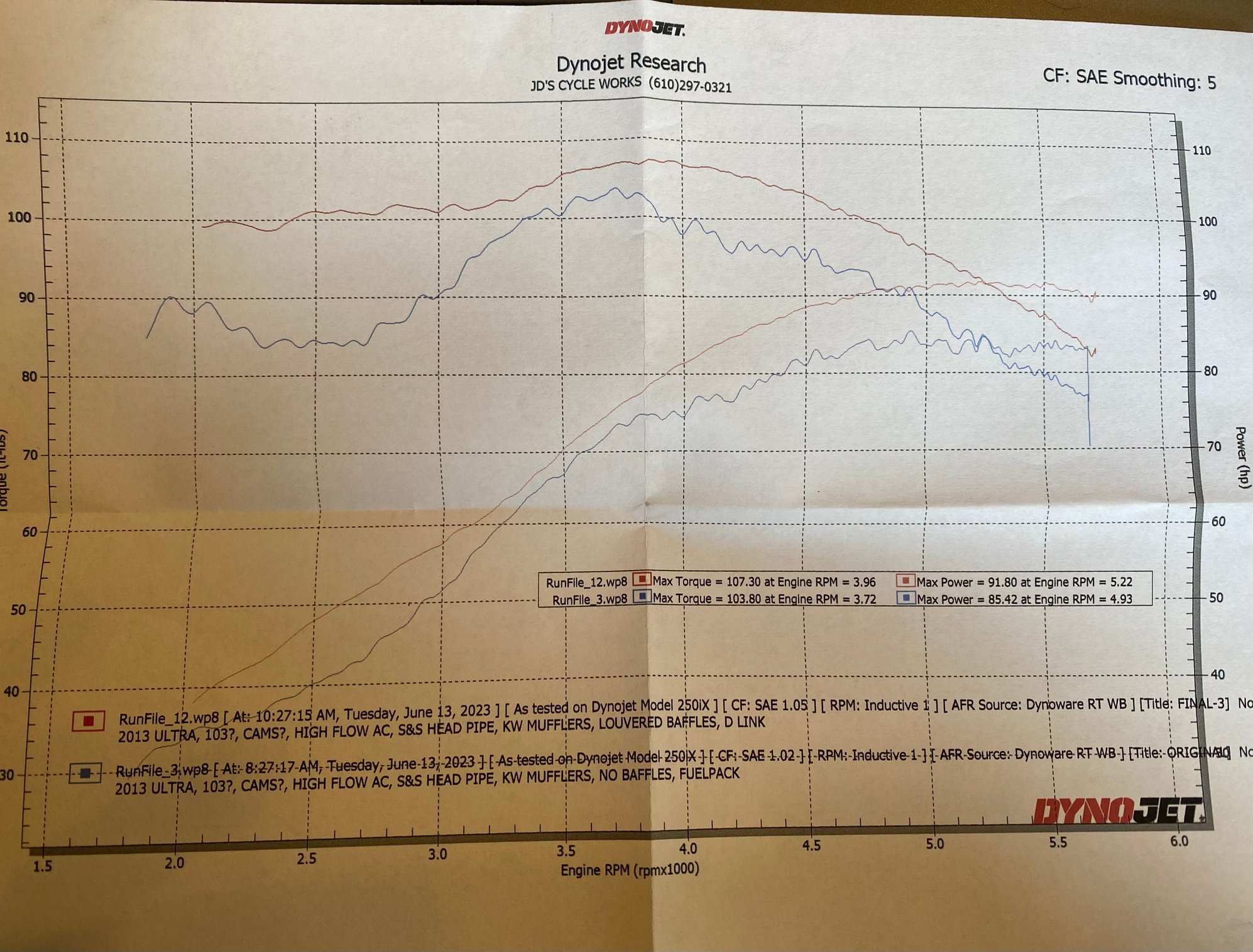

I had my 13 Ultra dyno tuned June 13th. I showed up with KW 4.5 and no baffles installed but the KW Performance baffles in hand. The tech said “you don’t want those you want the louvered ones” said you’ll pick up more low end torque with them. He had them instock and I bought them. He was right, I picked up 15 ft lbs of torque where it counts and the sound is just fine!

So you never compared the Performance baffle with the tongue that you had in hand against the louvered baffle that he sold you, is that correct? You just picked up 15 ft lbs over using a 4.5 can with no inserts?

I did install the performance baffles for one ride and didn’t really like the sound and removed them. The guy who dyno tuned my bike said in his experience the sound is better and you get a nice low rpm torque curve with the louvered baffles. I trusted his judgement and opinion. He did not do any runs with the performance baffles.
I was previously using a custom download from V&H with a FP3. You can see how he was able to smooth it out and pick up torque with the baffles and proper tuning.

Got ya. It's funny, when I bought my KW Dominator 2-2 I talked with Khrome Werks. They told me to get the performance insert with adjustable tongue for the best low end tq. My tuner said the same. I think mine is fairly loud especially if on the throttle. Going to experiment a bit with louvered and the reducers.
