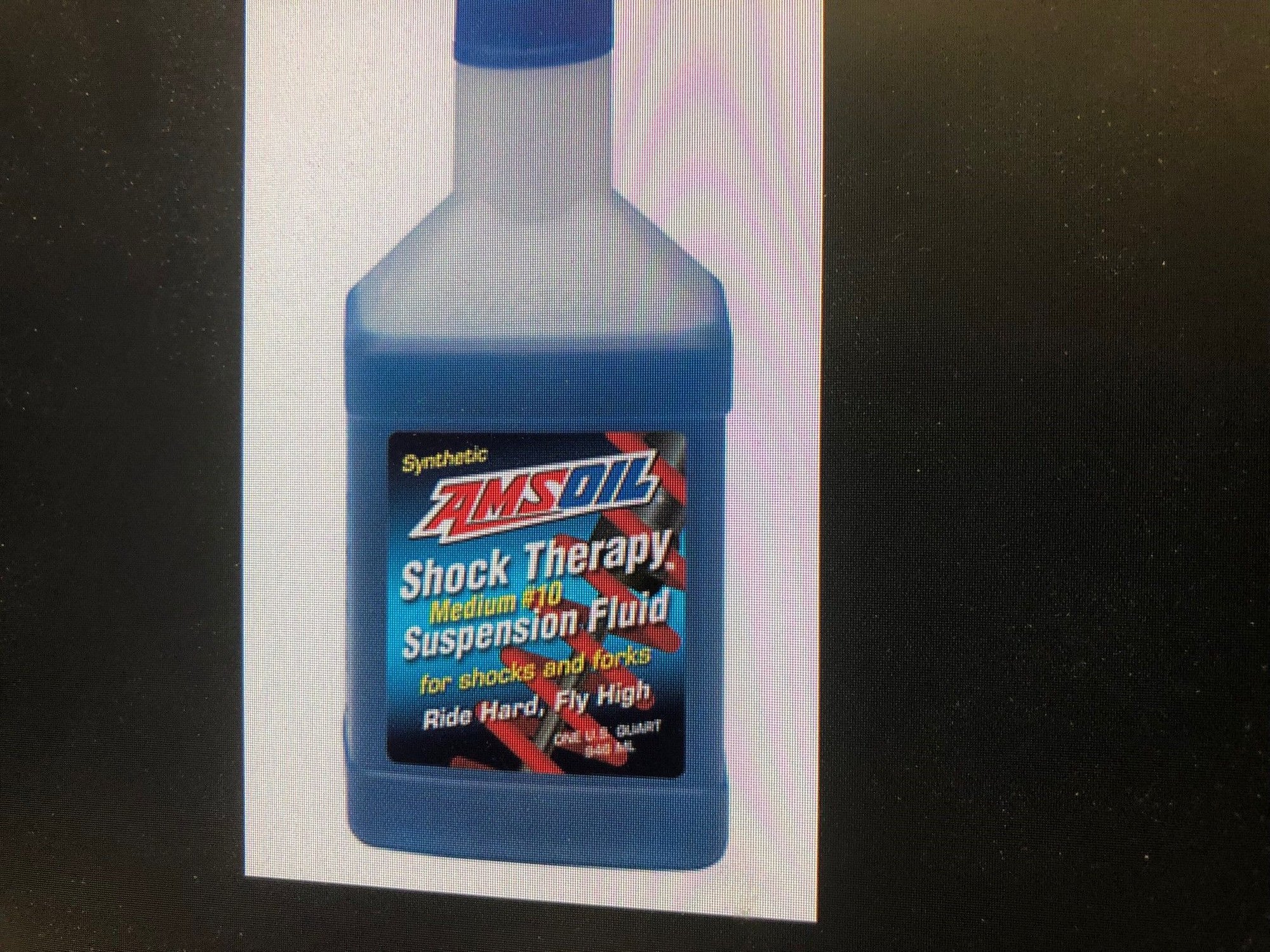

Originally Posted by leadman
I didn't know the shocks used fork oil .
Call it whatever you like
