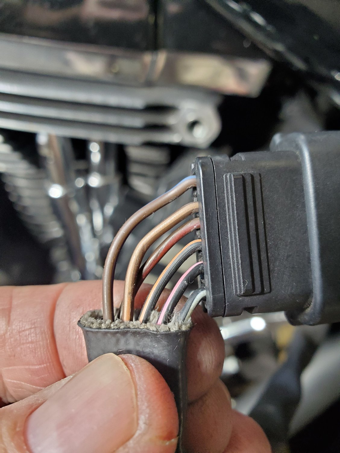

Check the plug on the back of the throttle body.
I agree with this. Apparently, if there's an slight change in voltage (from wires that can't be seen and are susceptible to fretting), it will cause wonky performance. I just replaced the connector and fix my erratic throttle response.
