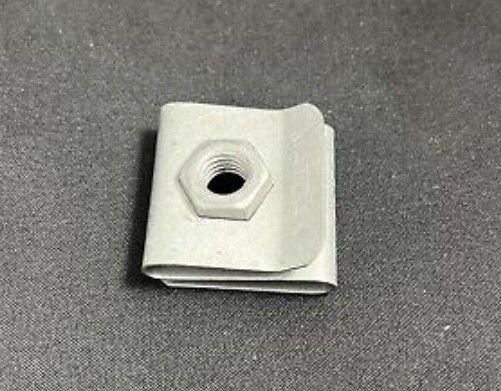

The matching u nut is rather common for frame side.

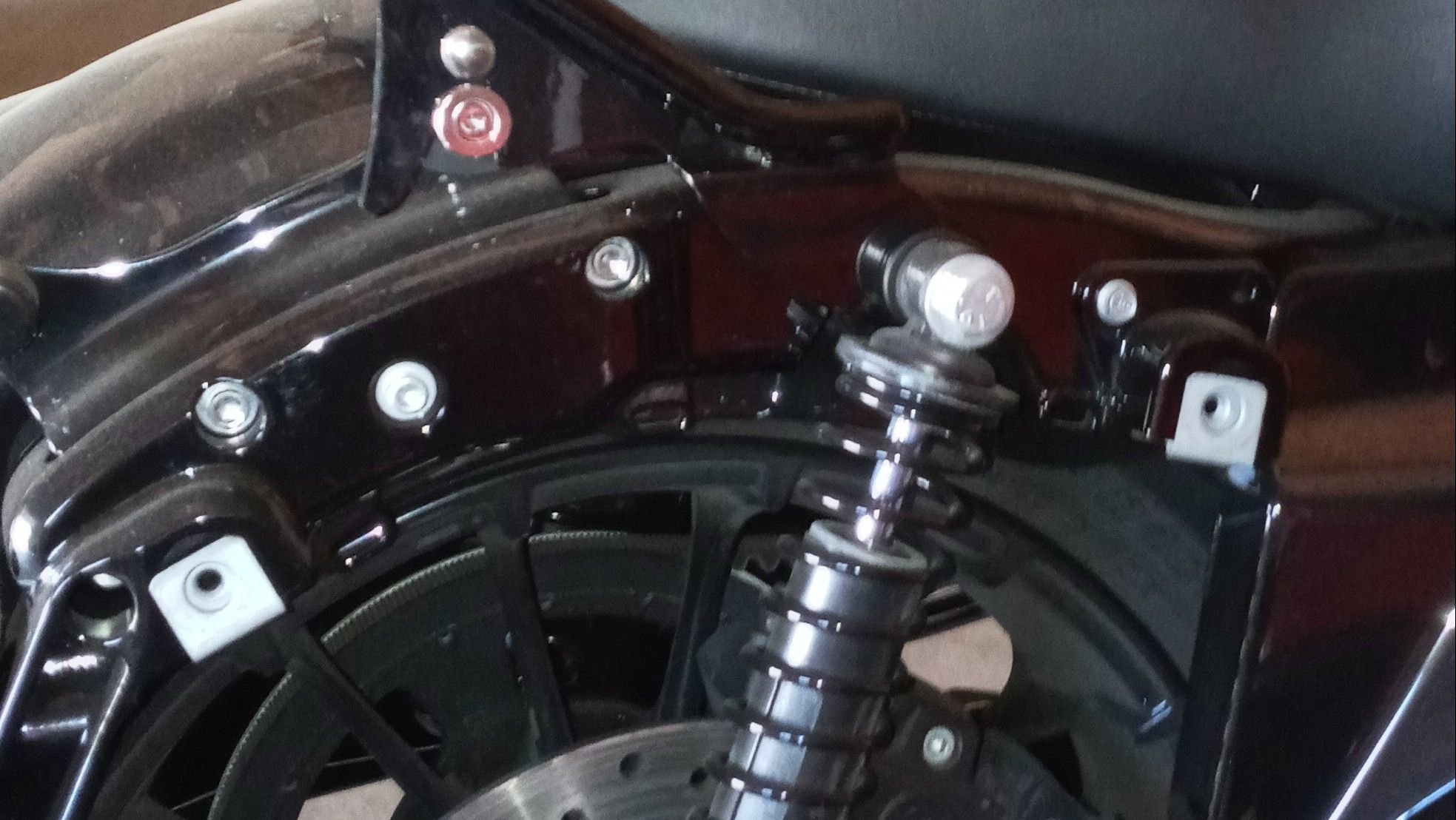

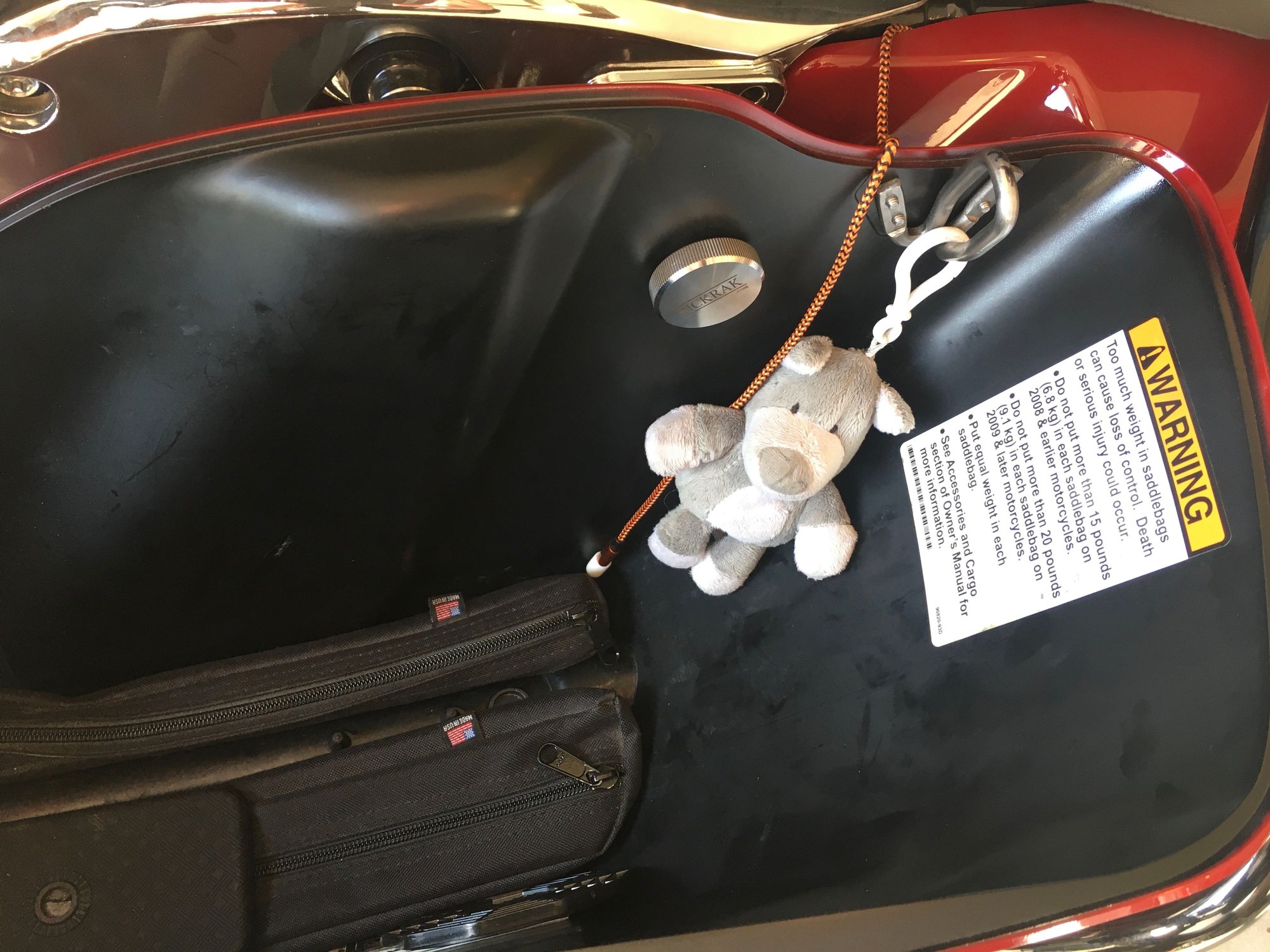

If it were me, I would route both wires through the bolt versus using the bolt for ground. Grounding the bolt would require removing paint where the u-nut clips onto the saddlebag support. Removing paint is asking for rust/corrosion.
Pic is my bike, but the OP's bike also has black painted saddlebag supports.

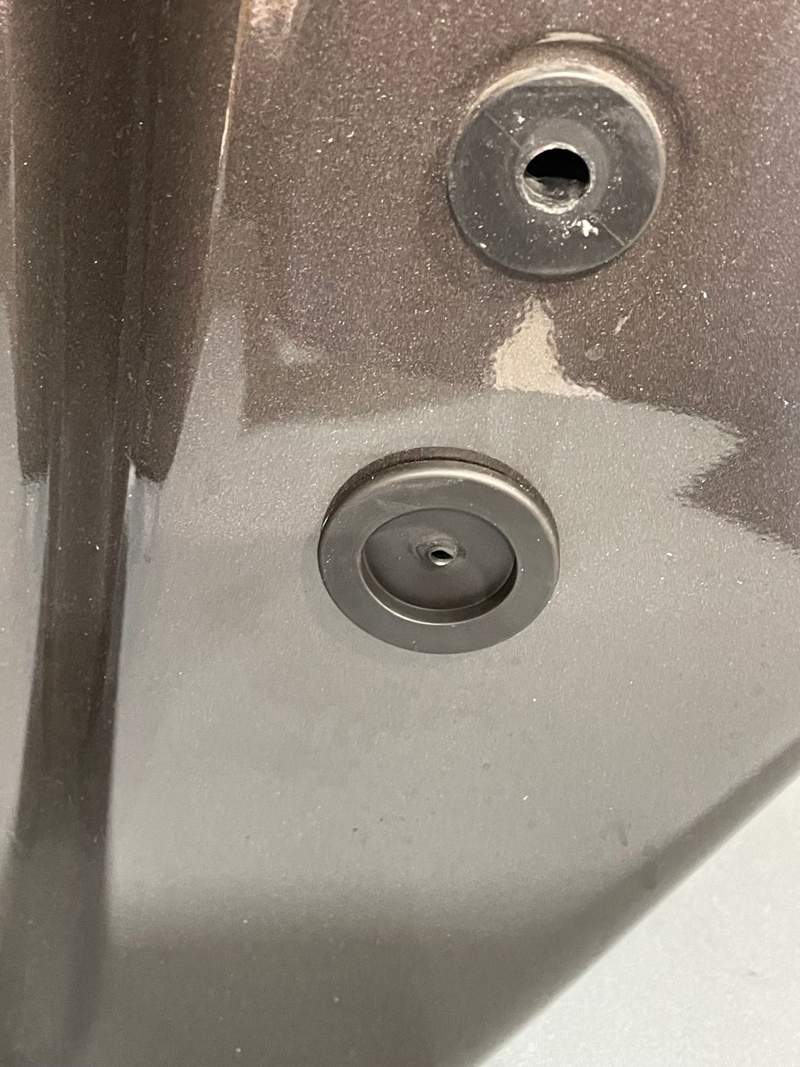

FWIW ... Drilling and sealing a hole is the side of one of the bags isn't a big deal ... I use to drill a hole of the bottom of one of the bags to let the melted ice drain when using as a cooler ... A rubber "Drip Grommet" worked fine ... Later I sealed it up with some black silicone ... On your scooter a short pigtail with the end matching the unit needing power and the other end with a weather tight connector would do for inside the bag... The line from the scooter to the weather tight connector so that it could be easily unplugged when removing the saddle bag should get you power ... Provide a suitable cover for the power pigtail when not in use ( rubber cap etc )

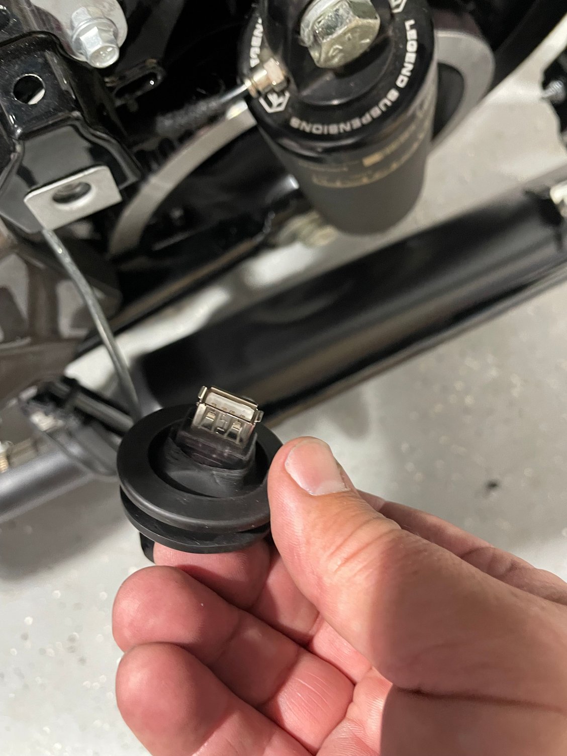

We drill a hole under the front saddle bag screw and install our saddlebag grommet (Made in the USA like all parts should be) that you can push the wires through. They were designed just to pass wires though saddlebags, so they are easy to install without any headaches. https://jacksonvillecycleaudio.com/s...sold-in-pairs/

Post 23 is a cleaner wider water resistant access point than the running thread design, although that’s a good idea as well. The grommet idea is hidden beneath the saddle bracket as well. They’re just bigger holes. “Measure twice drill once”. (Per side of course).

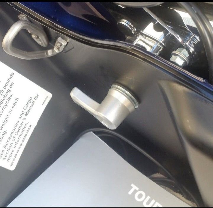

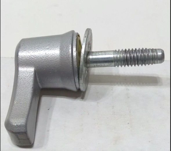

Quoting myself for clarification. When I stated "factory toilet flush handles", I was referring to the 2017+ bag fasteners. I believe the OP's bike is a 2022.
The fasteners are threaded, and screw into a 1/4-20 u-nut.
It may be difficult to source a 1/4 hollow bolt. The smallest I've seen are 5/16 with a 3/16 through hole. That being said, if a 5/16 hollow bolt is used, it may be necessary to ream the grommet out to 5/16 along with sourcing an appropriate 5/16 u-nut.
I don't enjoy the factory set up. But just tightening a theaded bolt in, while easier seems less secure. Especially since your really can't torque it down.
