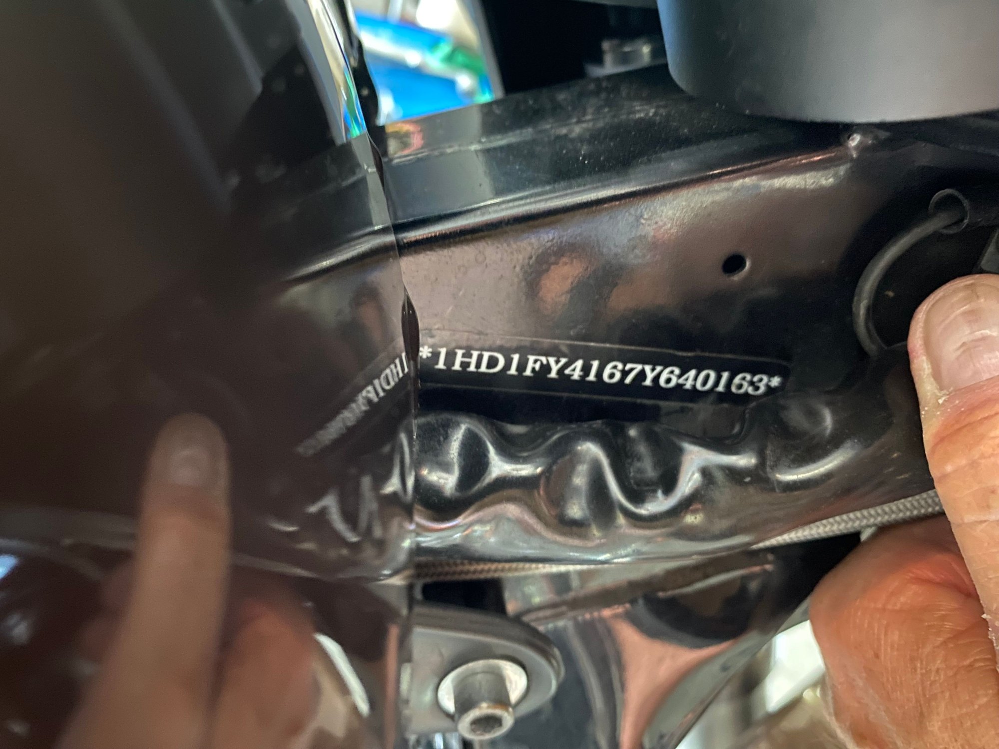

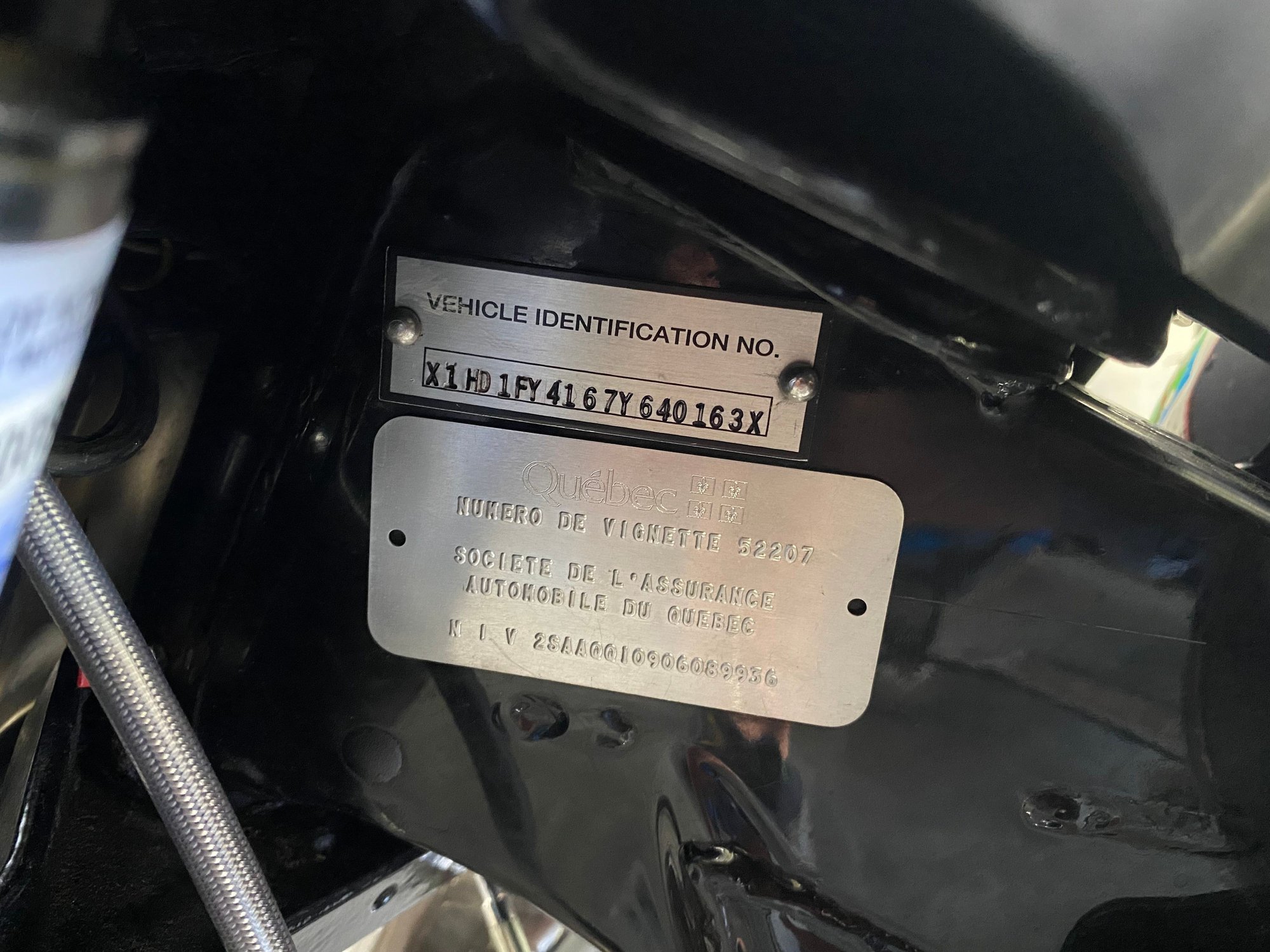

Originally Posted by Greg Clarke
I'm not even sure a 88ci with 5 speed tranny will fit in a 2007 frame, but that's what I have if the VIN is original
Those are NOT factory VIN tags.... neither the one labelled "VEHICLE IDENTIFICATION NO." nor the clear plastic strip with the VIN on it in white script, are from the factory.
Throw in the fact that it is a stolen vehicle recovery, that needed to have the VIN verified prior to sale.... you have no way of absolutely knowing, without the factory VIN markings, how that bike came from the factory... Having been an LEO for 30+ years, I couldn't count how many mistakes I've seen done by CA DMV on VINs and associated paperwork.
Have you found the engine number yet? It should be engraved on the case at the base of the cylinders on the left side (primary side) of the engine. I'm gonna guess that was removed also if the bike was stolen.... the first numbers tell model, year, and engine typoe, the last numbers match the last numbers of the VIN from the bike it came from. If the engien number is there, unaltered, that could tell you a lot...
And FWIW, I have a 124" S&S crate engine in my 2016 Ultra classic. You can install an entirely new engine into a bike, and have it look as good, or better, than an OEM install.
A 2007 frame is exactly the same as a 2001 frame… no significant changes were made to the touring frames until the 2008 lineup. 2009 saw another round of changes, making 2008 a unique model which included the larger, 6 gallon tank, but still the narrow swingarm.
