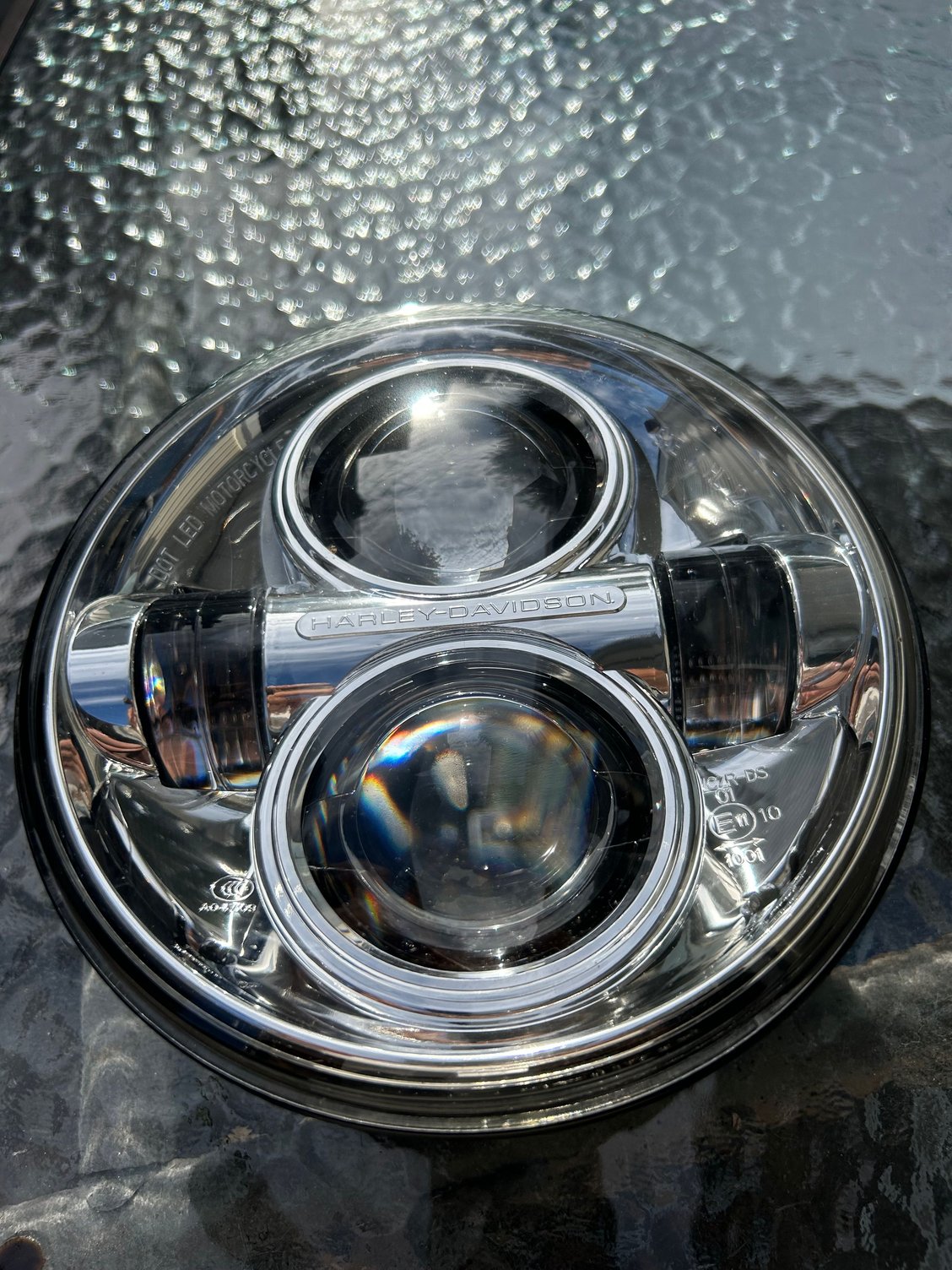

A co worker gave me this headlight for my streetglide. Do I need to purchase a separate wiring kit if so what do I need to get?

looks like the harley 7 in projector headlight. here are the installation instructions from hd: https://serviceinfo.harley-davidson....8?locale=en_US
if you go down to the very bottom, it will show 'service parts', there is a harness that you'll need.

Buying the harness tomorrow morning to install my ProBeam Custom Dynamics…

Is that from Eagle Lights? If so, your friend gave you a nice gift!

Lol.......... it literally says, "Harley Davidson" dead square in the middle of the headlight! But yes, it was a good score from his friend tho..........

It’s a Daymayker stock headlight. They are pretty decent
