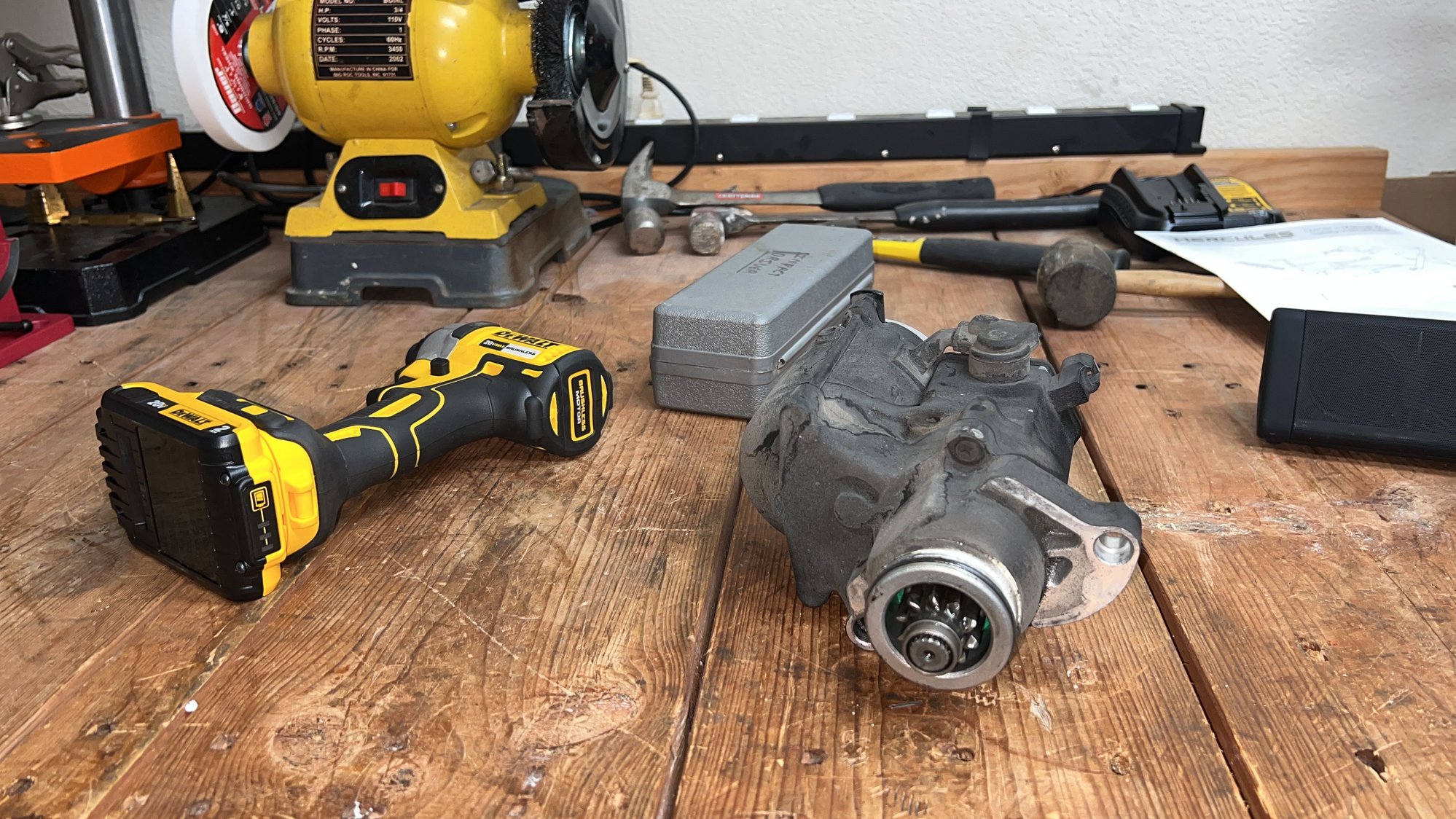

Great info here, thank you all for our input. I cleaned the pins etc in the plugs, made sure the regulator was grounded well and put everything back together with some silicone grease on the seals. I had to pull the starter to get good access where the ground cable attaches to the top of the transmission (Thanks HD) so I put a new starter on. I DO NOT recommend Amazon starters (I know, I know...). Took that grinding POS off after a few starts and saw it was chewing the ends off the clutch hub teeth already. Sounded like back in the day when a Chevy starter hadn't been shimmed properly. Ended up pulling the old one apart and freshening it up with a commutator cleaning and new grease. Spins over nicely now.
How do you resize pics on here? Sorry for the size.
Scamazon starters - No bueno.

Myself, I don't go with no name brands for critical stuff. When I replace fuel pump, could get one on amazon for well less than half. Something that critical, I want a brand I have heard of. I am sure some would say they are all made in China anyways and I am wasting money
