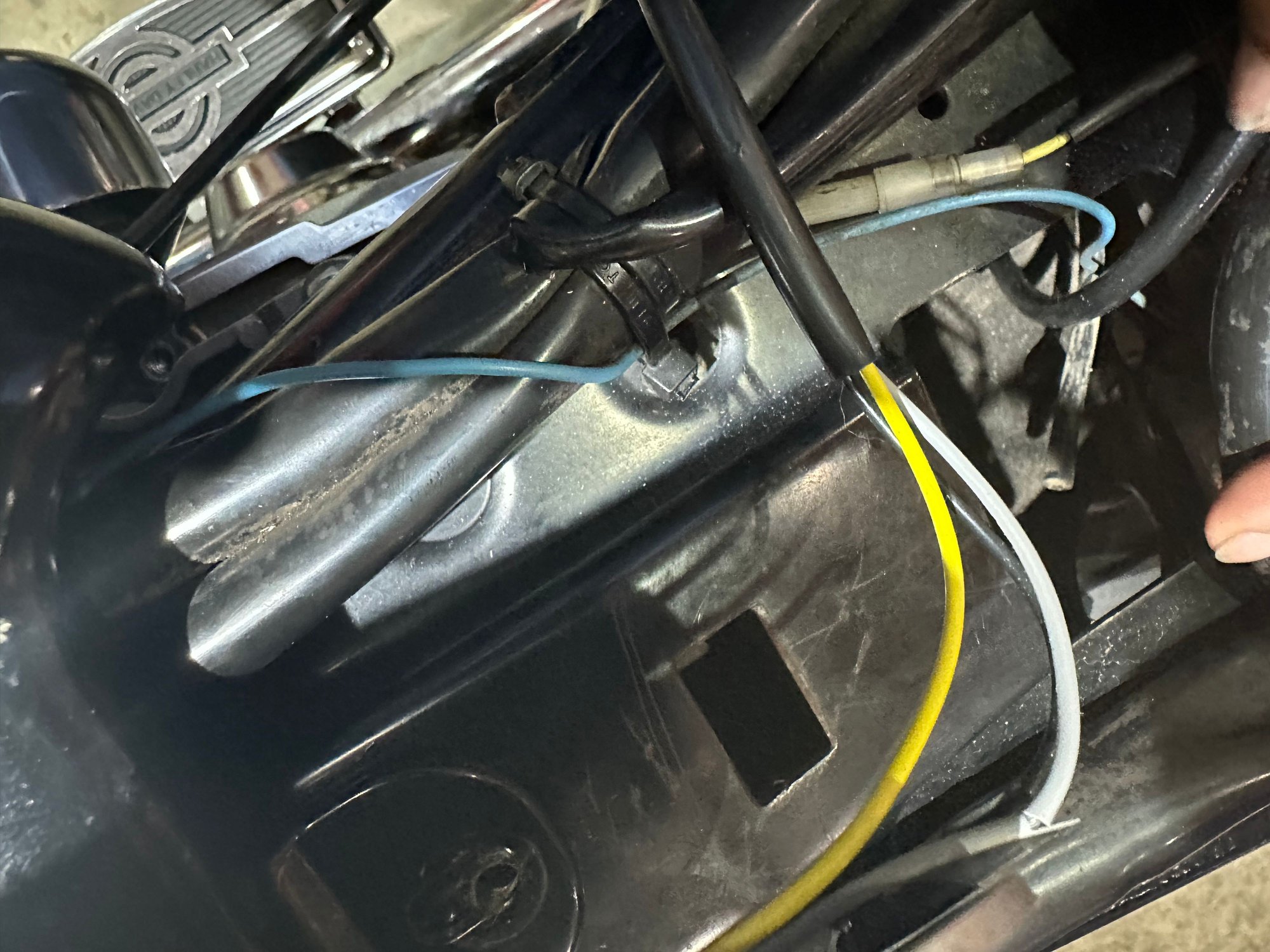

As my tins are off for paint, I have no "gas system" so I purchased a used tank to fulfill that role. I also purchased an in tank filter, pump, and other internals. Do I connect an EFI hose from the filter (out) to the spout on the inside of the tank? This tank is not the same as my 99" Roadking. My tank has dual caps. How does the electrical get set up? It does have the dual hoses on the bottom of the tank. Will this set up for for my Roadking? My Roadking has a "dash" that covers this fill opening... Any help is appreciated @470004

this harness comes off the EFI system. What is this single blue wire for?
this GR/Y wire is from the bike
top of efi wiring
does this yellow plug go here?
does this orange/black harness from the bike plug in here? What about the gray wire?

Anyone know where the grey wire hooks up? I think I have this mostly licked. I'm thinking it attaches to the green/yellow harness from the bike?

So I thought a lot about this wiring and finally figured it out.

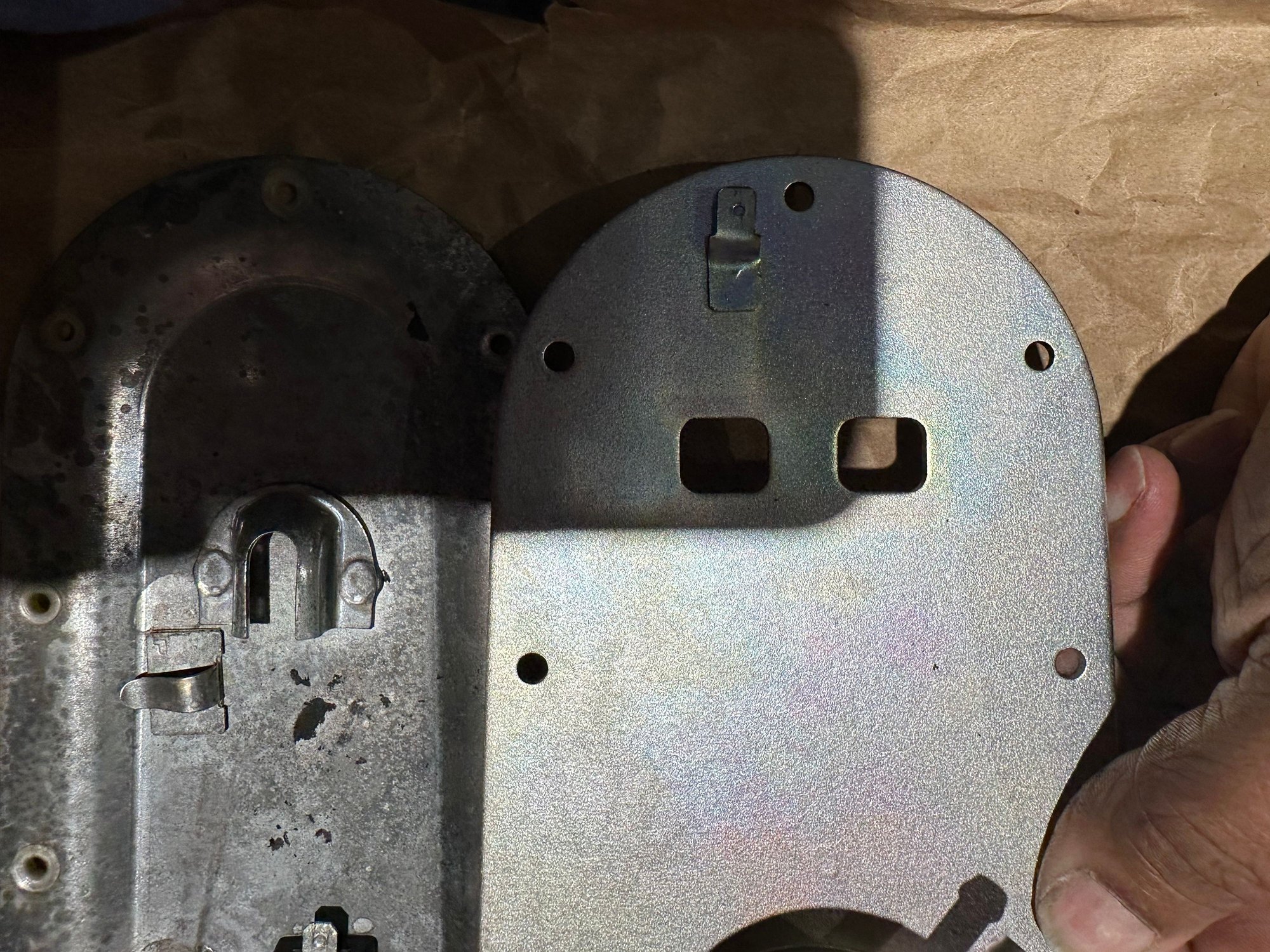

Correct tank plate

Default What I purchased
I need to convert my base plate to match this base plate.
These holes need to be created for the rubber seals
