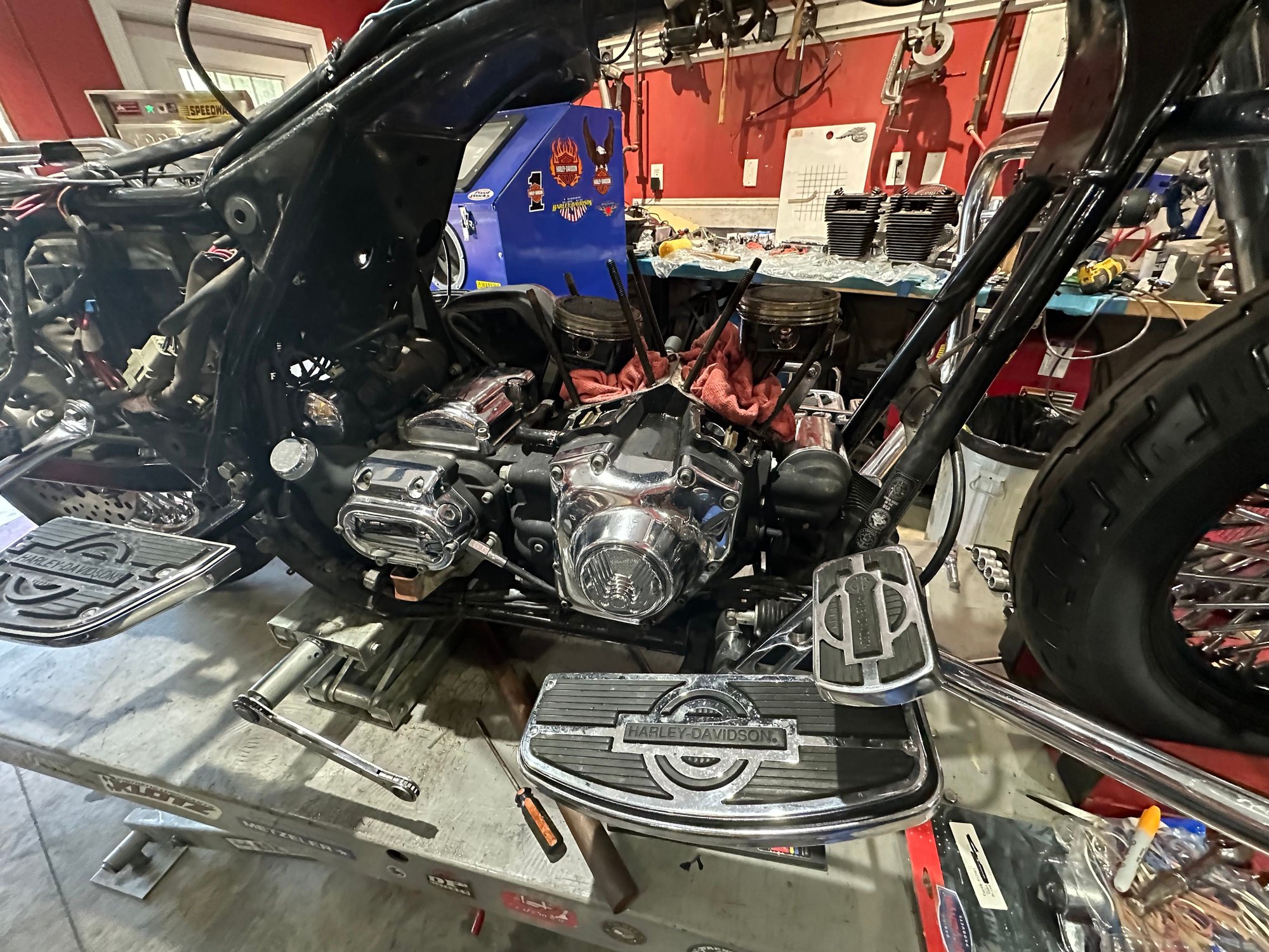

I used to be an avid painter, but no longer have the time to do it, so I sent the tins off for a refresh. In the meantime I wanted to get into the cam chest. So off came the intake on my MM
Old Nov 6, 2023 | 04:57 PM
pennafxu's Avatar
pennafxu
Joined: Nov 2023
Posts: 78
Likes: 66
From: KY
After cracking the cam chest I wasn't surprised that after 30,000 miles the cam chain tensioners crumbled in my fingers. The good news was that my crankshaft pinion runout was .0005" along with a crank pinion deflection of .001" So a total of .0015" That was an awesome feeling that a worn out TC88 had such tight tolerances! So then it was engine building time...

I stripped down the engine in quick succession...

I installed new cam bearings and a Feuling HP plus billet cam chest kit, and billet Feuling Oil pump. I upgraded to hydraulic cam tensioners and went with a chain drive. I could have probably gone with a gear drive due to my tight tolerances, but you have to keep closer eye on such setups. I used a 130 shim to line up my gears and went with Feuling Reaper cams (No Bullshit, Just Performance) 543's
