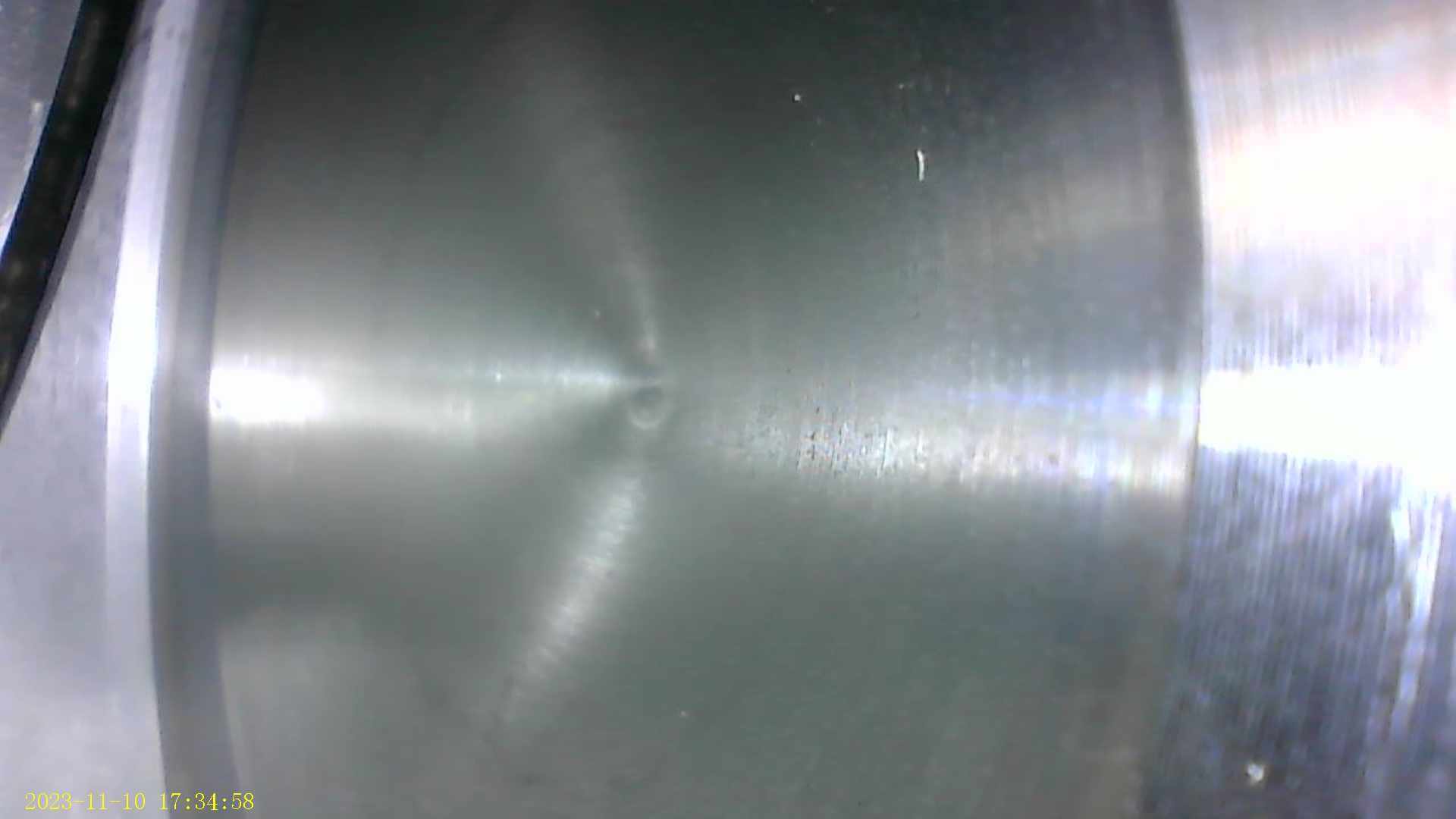

Some shots of the internals... Practicing for the live break-in
Down the spark plug hole
Crosshatching... top of piston
piston returning to the top
