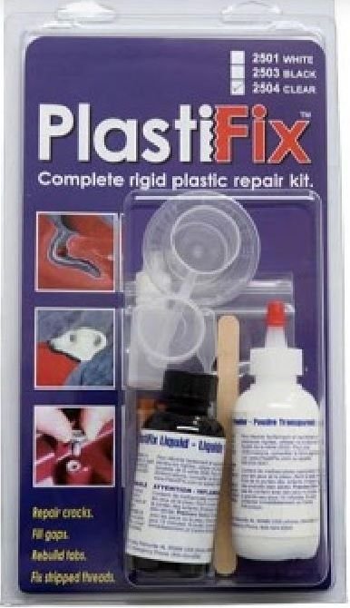

My mechanic got enthusiastic and repaired the fairing stand-off with this. It feels and looks pretty solid. Time will tell.
