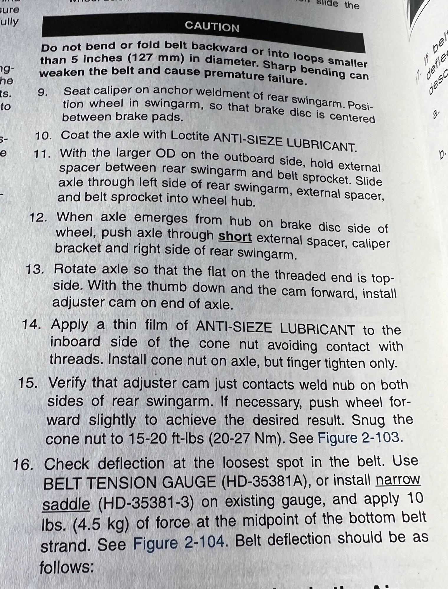

Originally Posted by foxtrapper
FSM says cost the axle (10) and thin film on the inboard side of the nut (14). it lubricated, to prevent the nut from turning the snail under it as you tighten it down.
Design certainty isn’t convenient, easy and several other terms. Always thought it was odd how far out you went on the snails, as it made fine adjustments darn fiddly.
I got by well enough with two large wrenches myself, one on each side, working from the rear. My left hand holding the axle as I want, my right tightening the nut.
Well would you look at that M Oclaf? How do people think this stuff up? Have you tried the crow with that banana?
Thanks Foxtrapper.
