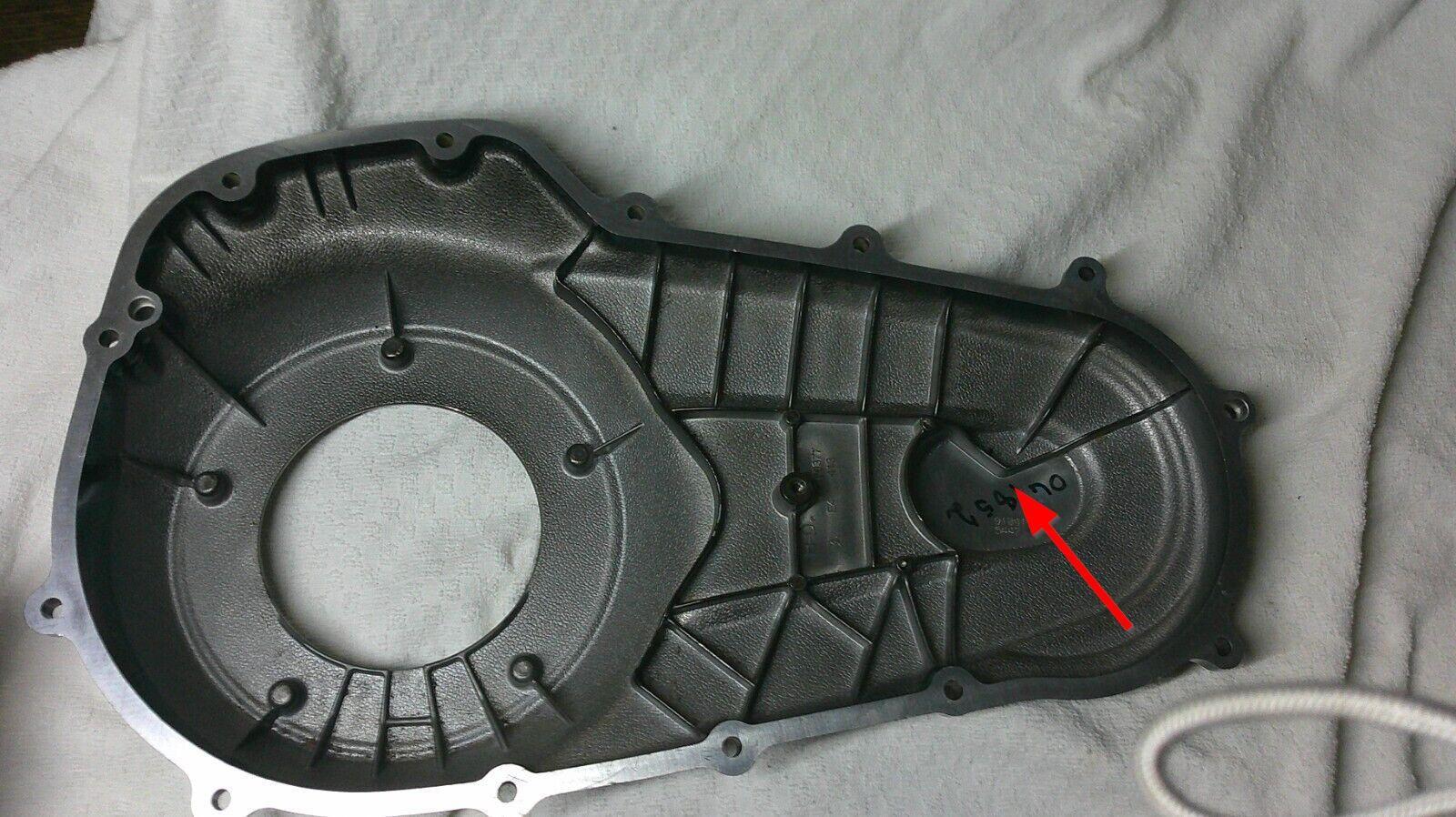

The first thing I would say to check is that who ever installed the compensator either glued the plastic oil scoops inside the outer primary cover, or that they installed an updated outer primary cover with the oil scoops as part of the cover, meaning they are aluminum and part of the outer primary cover.
Without oil being directed to the T70 torx bolt the compensator will fail as did the earlier SE compensators. Then they become noisy.
