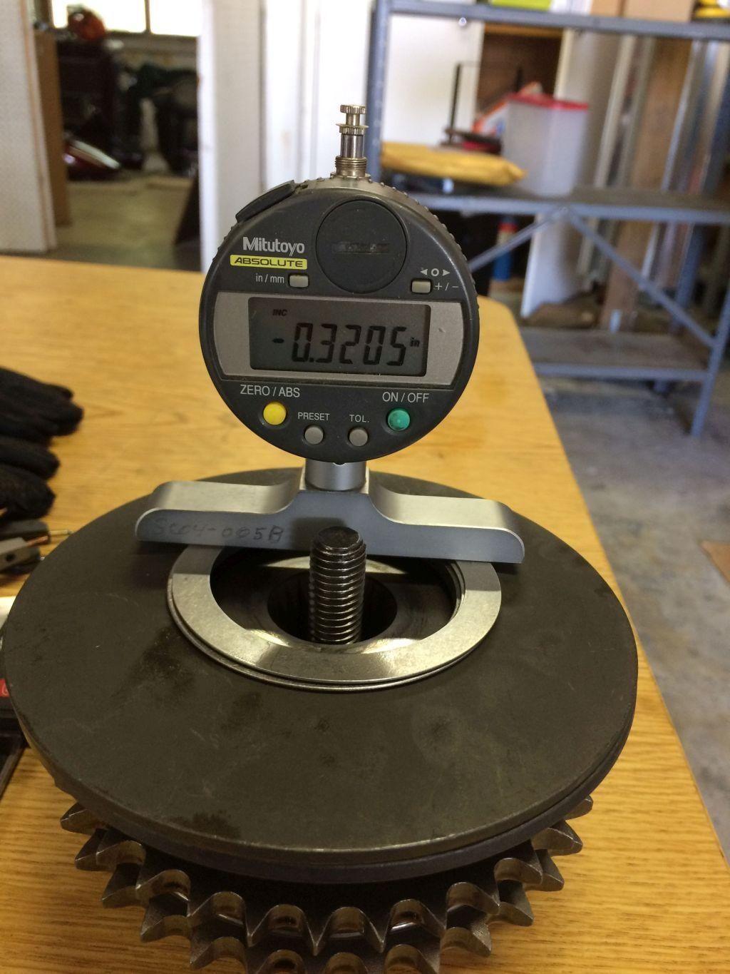

FYI.... This was shared on another forum from a guy who runs a shop in the Midwest.
It was the first I had heard of shimming the newest version of the Twin Cam Comp (with the oil scoop)..

Yep, Joe shared this with us several years back. i check them all now, new or not.

I read down through there and didn't see where you took it all apart. Your sprocket may look like this. With Harley's uneven firing and always a little hunting in rpm it makes an uneven sound, sound worse. Doesn't hurt anything but the noise will drive you crazy unless you just ignore it.
Tension (from shim stack) looks fine. It's not going too far up the ramp for your driving style. It's doing its job.

I installed the current style comp on my previous bike and after a 1700 mile trip the comp was rattling and loose. Installed shims and all was smooth and quiet again. As was recommended above, when installing a new comp install the shims also and avoid having to go back in later.
