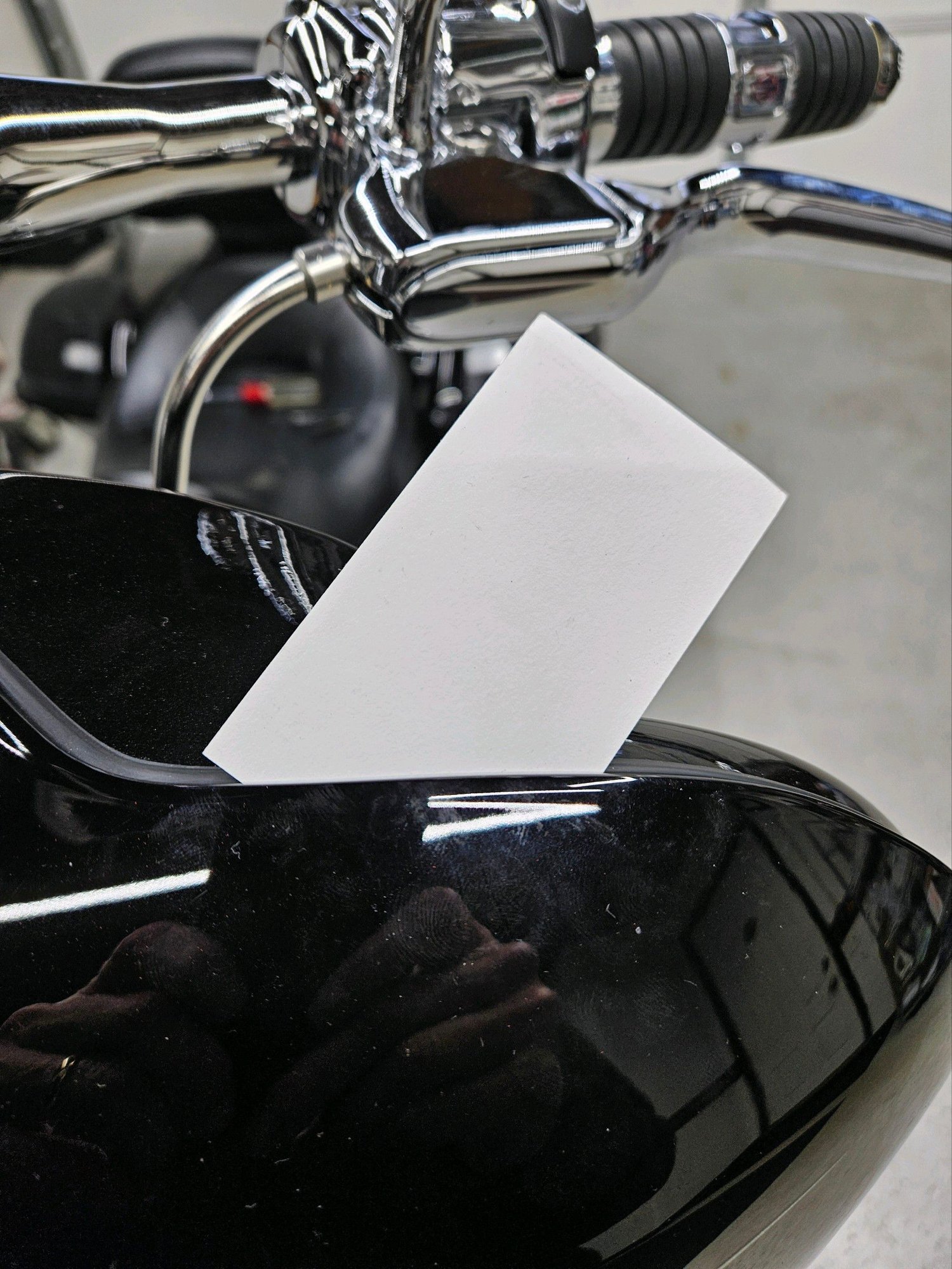

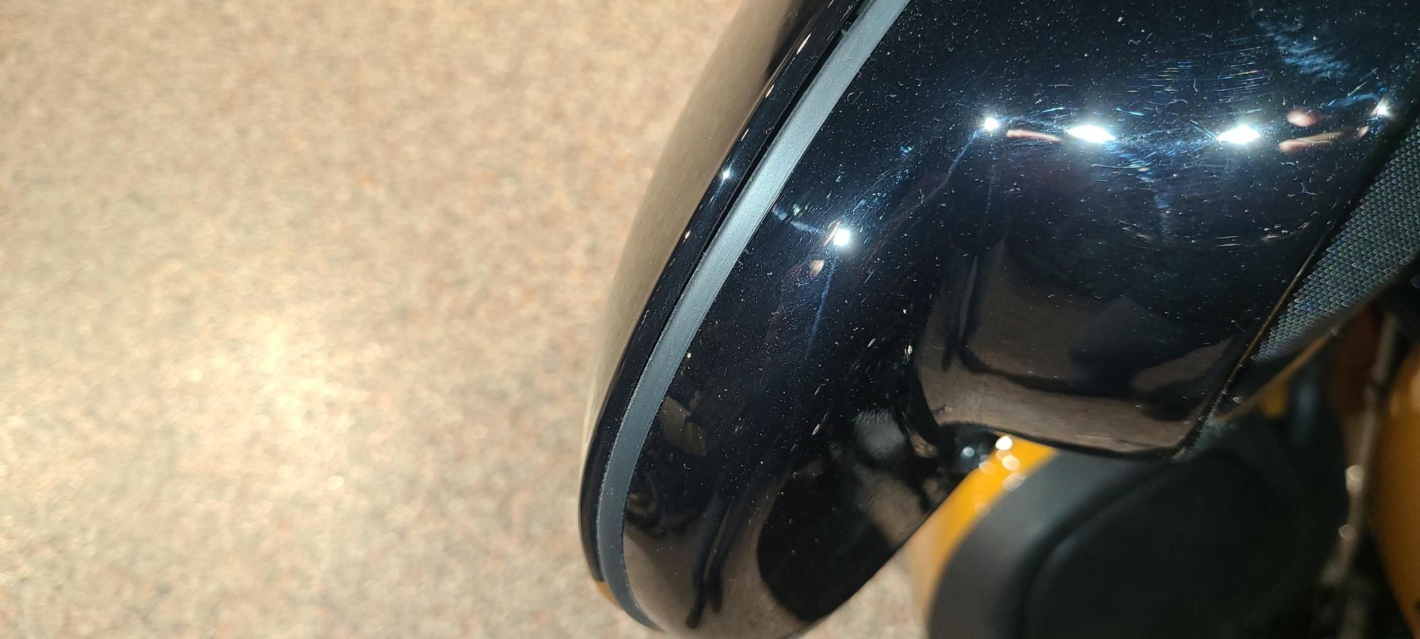

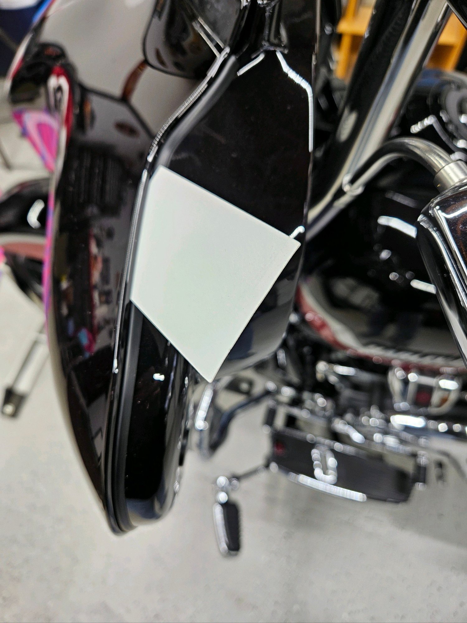

These were all on Street Glides
Business Card slides in
Zoom in on this puppy

I think finding a durometer of 20-40 is going to be the hardest part. I'm thinking just lay it in there so it's pinched and tighten up the outer fairing.
Durometer 20 is like a rubberband, Durometer 40 is like a pencil eraser.....
I may just leave it alone for now and try again when it's 90 degrees outside.....

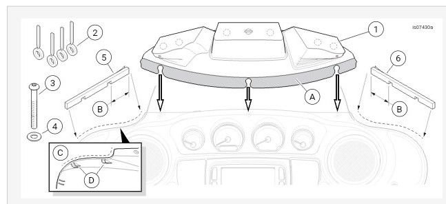

After I installed a Freedom Shield on my 2018 Street Glide Special, there was a slight gap on both sides. Freedom claims their shields are 30% thicker than stock. I ordered the seals that come with the 3 pocket fairing pouch to fill the gaps.
Back in 2018, they were about $5 per side.

Wow, thanks for that info, that may work perfect!
LOL, the LH side is more expensive, go figure......

Found a dealer who has 1 on hand, pick it up Saturday.
I wonder if this goes on in addition to the seal that's currently there or do I cut out what's there?....
