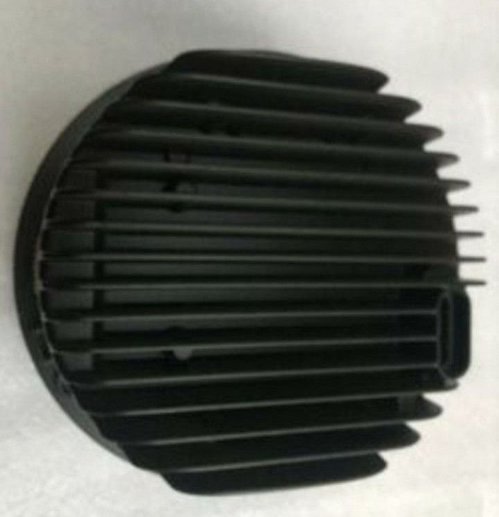

I just put it all back together and now both sides have a space, I'm starting to think it's the LED Adaptive head light that has
that heat protection grill on the back of it, preventing the fairing from sitting properly.

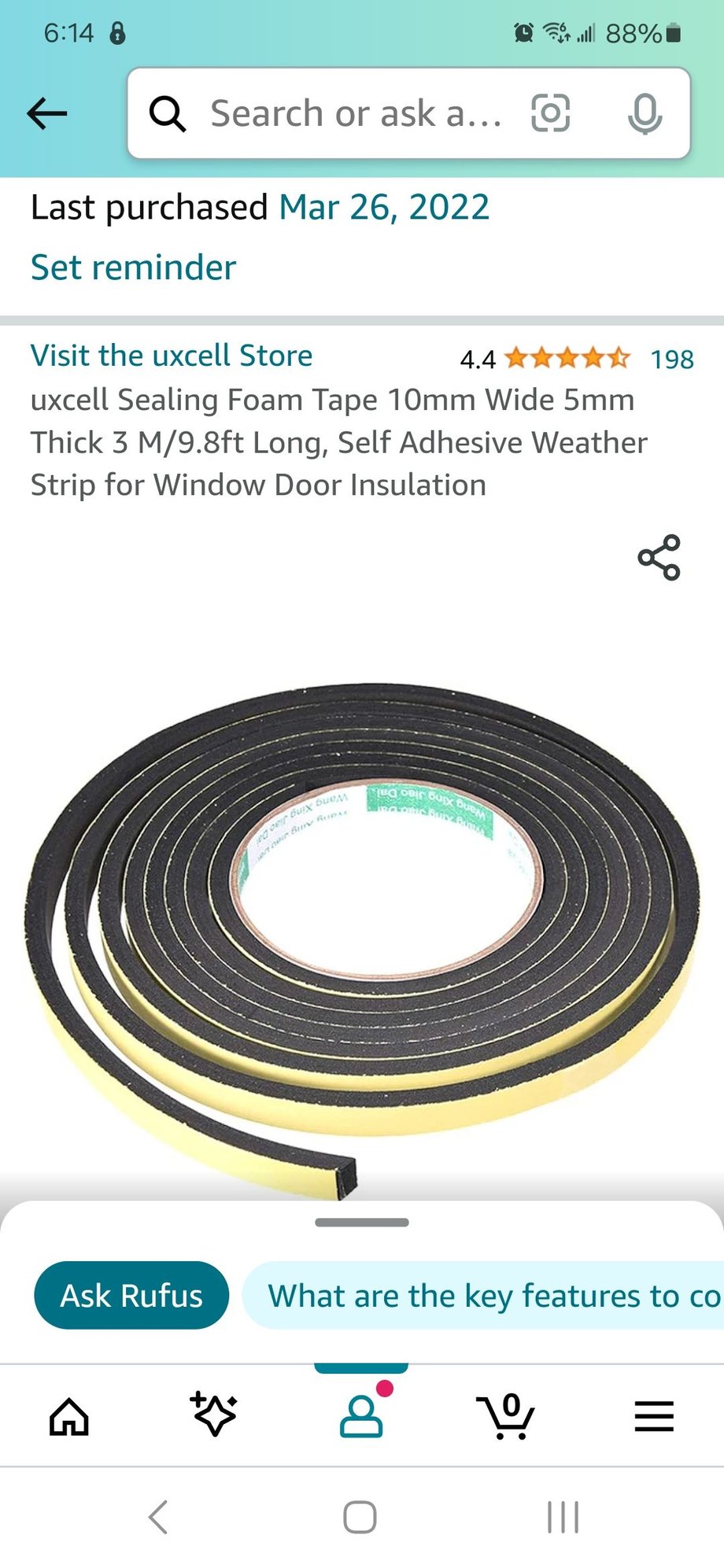

No need to cut/remove what's there, just line up the edge alongside the OE seal. It sticks to the inside of the outer fairing, don't overlap the edge over the OE seal. Clean the surface with an alcohol wipe prior to application. You may still notice what appears to be a slight gap, but the gap is now watertight.
I found it odd that there's a difference in price between left & right. They're side specific due to the location of the cut-outs, but they're basically a mirror image of each other, both are identical lengths.
Interesting diagnosis. The batwing models that are factory equipped with non-adaptive LED headlights don't utilize the heat protection grill that is present on the adaptive version.
Does the adaptive version produce more heat than the non-adaptive version necessitate the grill? IDK.

I have a thicker windshield and a organizer inside the windshield. I purchased this on Amazon and it works 100%. It comes in different thicknes and widths.
