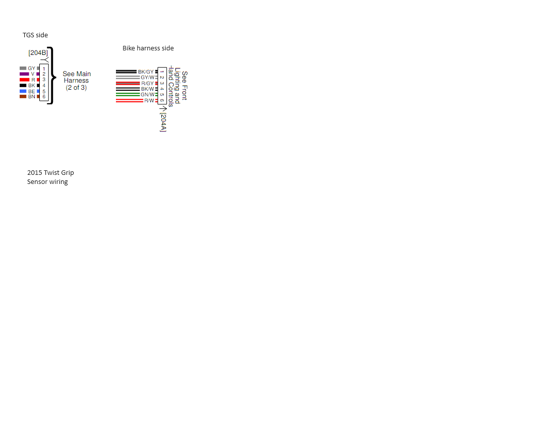

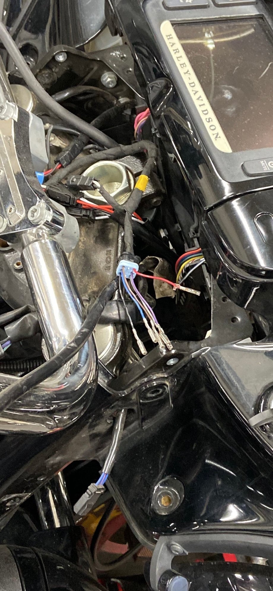

Replaced my bars on a 2015 street glide. Once I start the bike the throttle is stuck and revs all the way. Anyway to reset the tbw sensor? Thanks

Sounds like you have a couple wires in the wrong slots. Disconnect the throttle position sensor, and verify/correct the wiring.

There are two pairs of red / black wires. Make sure you didn’t get the switched.

Git it's fixed. Had my 6 wires all in the wrong slot rushing it set me back. But now everything works. Thanks fellas
