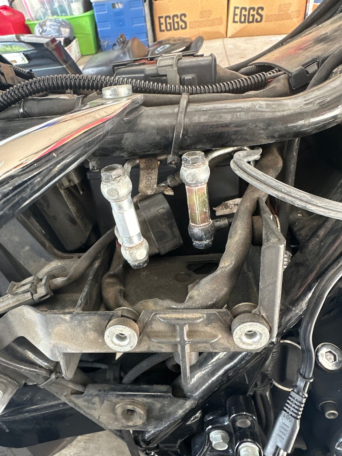

So I got out this morning and found out once I did a diagnostic check only had one code and it was the ABS issue,
so after further looking into it and checking all wires which were fine, the ABS module has been completely bypassed as seen in picture. So gonna get one of those maybe from eBay ,

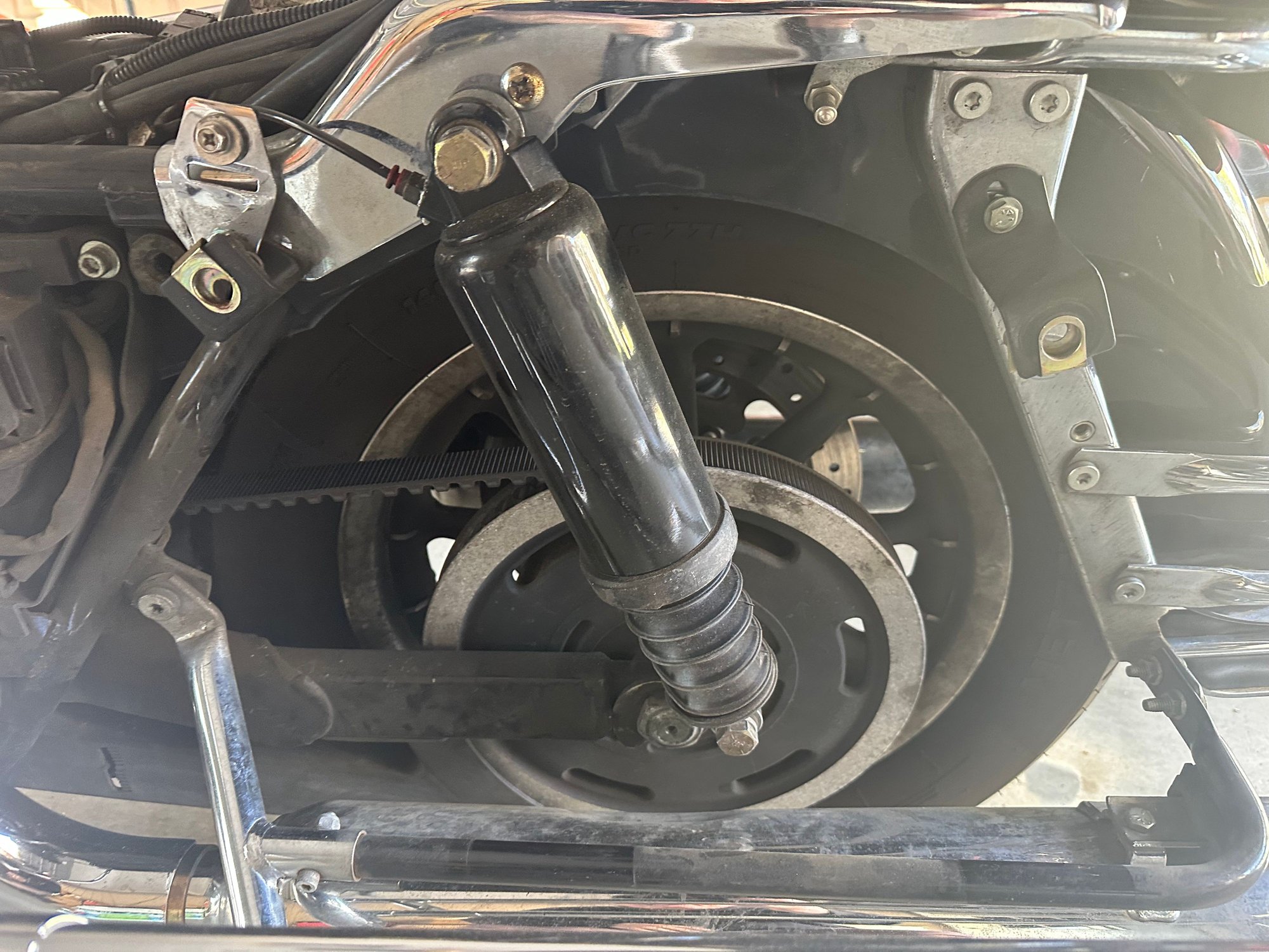

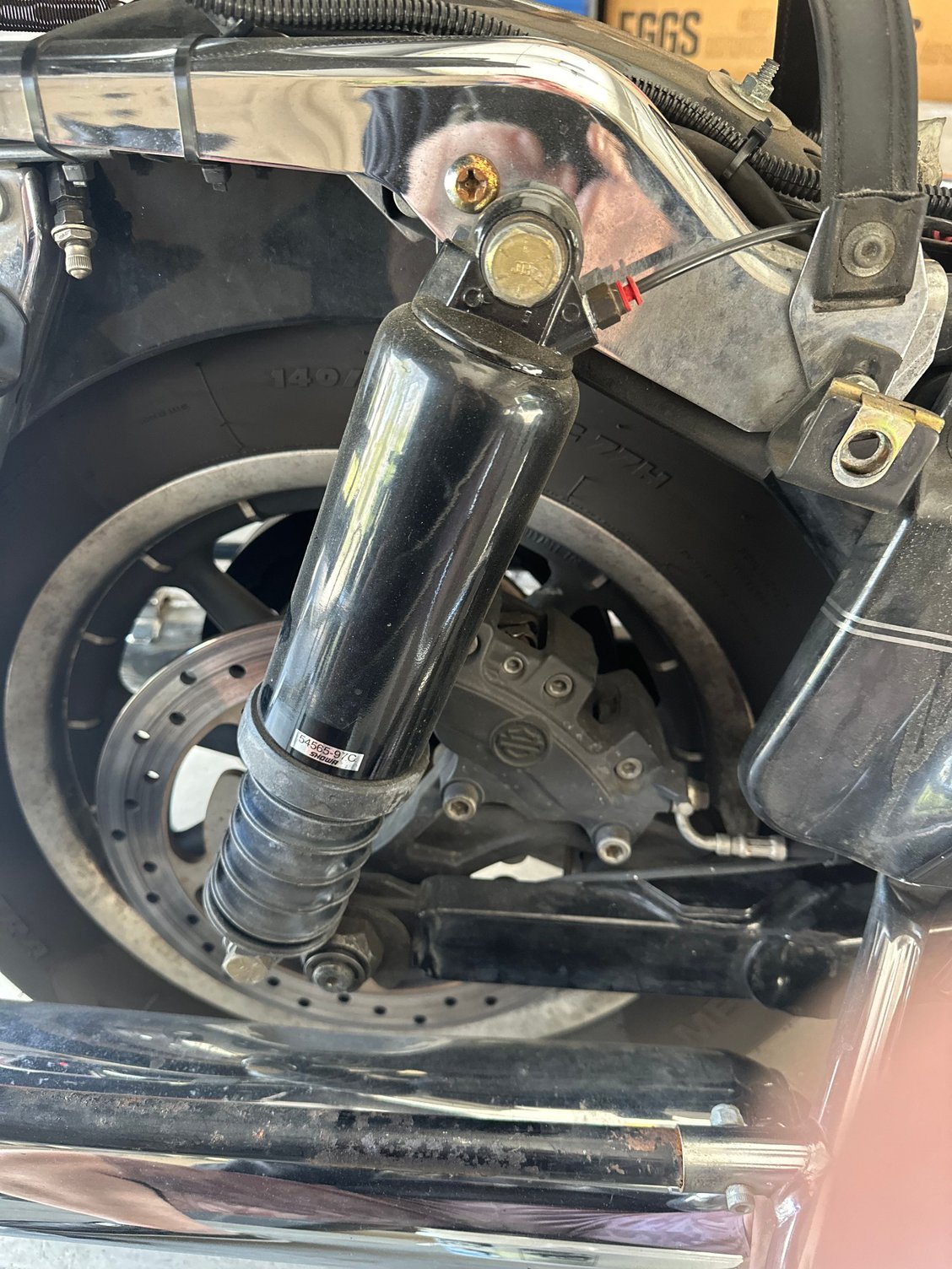

next the shocks hold 25psi on right side, the left side holds nothing, so maybe a bad seal ? Either way gonna replace these shocks also.
so at least I know what to do, also when I put this module back on, I guess I should also flush all brake fluids ?
thoughts on my next steps sound right ?

Well, I think that answers your question about the ABS issue.
you are absolutely right 😂😂, I was like what the heck lol 😆
At least the by pass job looks clean Well done

Brake fluid needs to be flushed every 2 years max anyway - when you have an ABS module back in there.
