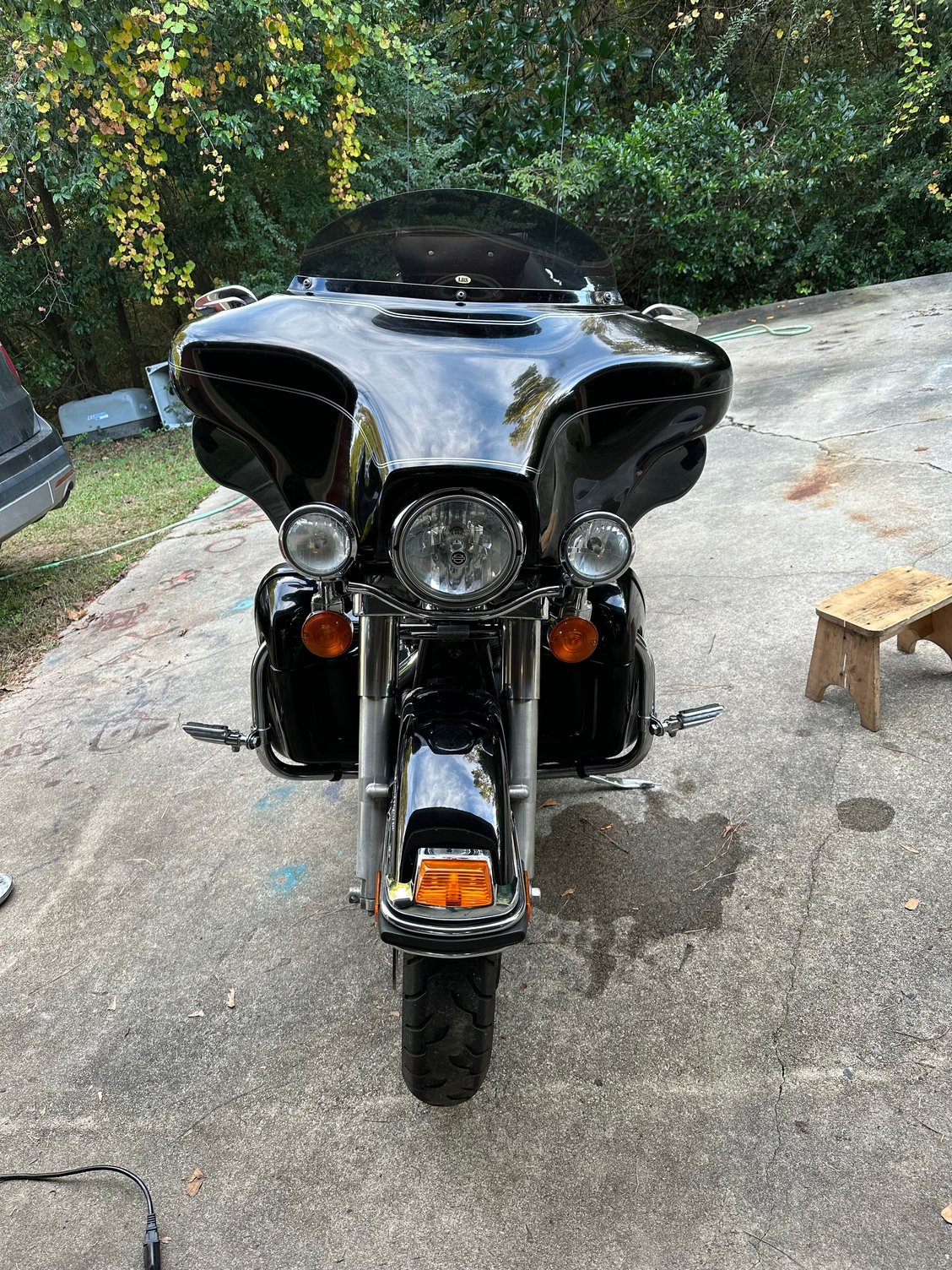

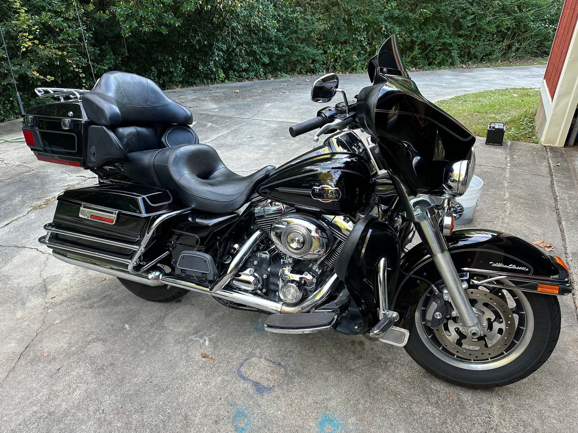

Appreciate you taking the time to read this 😀,
I now own a 08 Ultra Classic FLHTCUI 6 speed with the 96 motor. It’s all stock with 35K miles. Since owning now since Sept 2023 , I have had HD service on it and we took in October to first bike week In Pananma Fl, she rode great all the way there and back running 93 octane or non ethanol when around.
I was told by owner that he removed the shocks they kept leaking and he put regular shocks on and no more issues. The bike sit for about a year with no long term use, is what he said. The other thing was the yellow ABS light stays on, he says he was told $1300 to go away so he never fixed it, by ABS all work fine. However I now want to repair it.
First question , How would I go about finding the cause of this, I have ordered a HD shop oem service manual.
Second question , I am noticing when my self and wife ride which is about 450 pounds all together , not a lot but there are areas on the ride
where in the rear we bounce or bottom out kind of hard. Should I be looking at putting back on new shocks, or checking air PSI in them currently ?
Third question, I am at the moment would like to change exhaust , and air breather. But wondering should I buy a tuner first to see what it comes up with in the map codes or I guess I am trying to say running as should be. And what Tuner do you recommend I get.
appreciate all the help , just want to start making changes the right way to get the most from my Lucille now, thank you and ride safe and free 👊👊
This is Lucille Dublin Ga resident

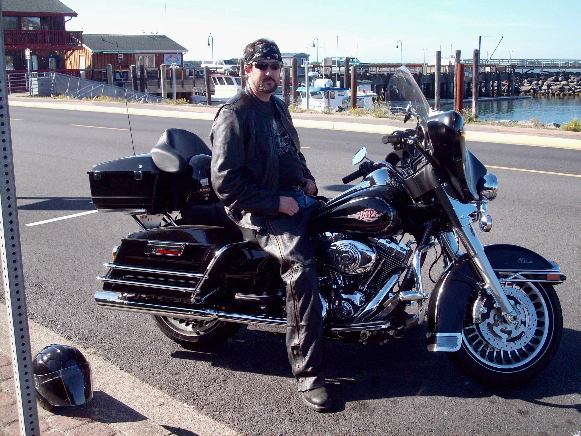

that's a clean low mileage bike, congrats! ok, going to throw this out there just because I can't help it..in 2009 they changed the frame on the Touring models and it was a big improvement..I could not believe how nimble and sharp feeling my big heavy 2009 Electra Glide could carve through twisty river roads..if you plan on riding for a long time you 'might' look at a post 2008 before sinking too much money into this..the frame change is well recognized by the Touring community as significant from 2009 on..sorry I know that is NOT what you wanted to hear "you picked a fine time to leave me Lucille"
edit: in the spirit of 'pics or it didn't happen'

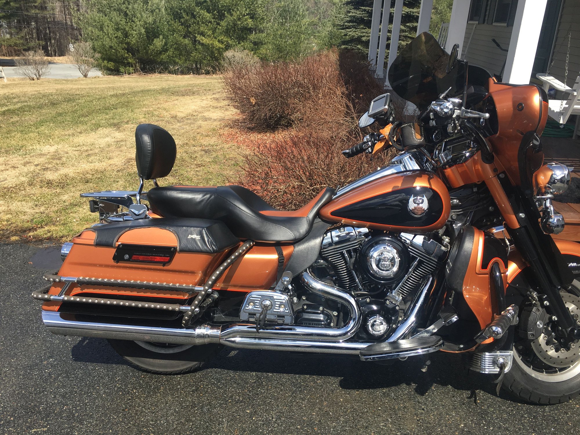

Had my 08 ultra from Aug 07 until Jun 19 when I finally traded it. Was a great bike. I changed the gearing to fix the too tall gearing (HD changed gearing after 08), dropped in a 575 cam, and changed exhaust and AC. The rest of the mods were all non-engine related.
