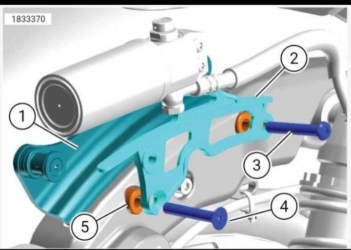

The remote resivors on the CVO RG ST are tucked in between the bags and fender.
HD makes a kit that will move the OE resivior brackets slightly outwards to accommodate their line of detachable accessories.
If you put a detachable tour pac on the detachable hardware, the resivors would be barely visible from side or rear view..
