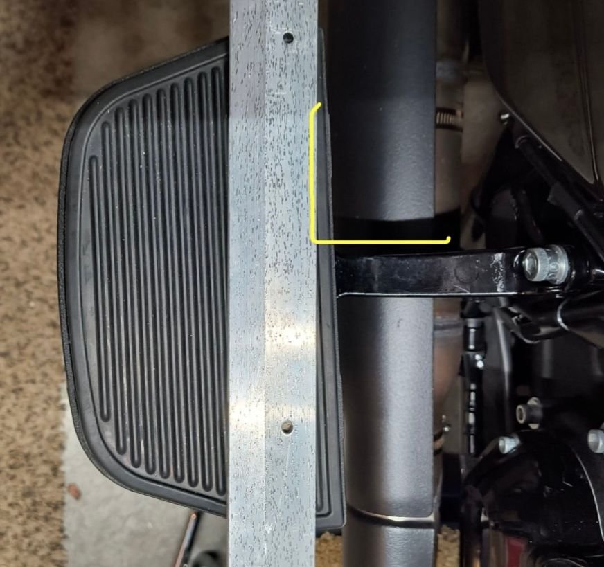

As much as that sucks (visually) .........I say leave it alone. Nobody is EVER going to notice that. Thats going to take way too much effort to fix. Once you start grinding, you cant put it back. There isnt much of a way to make sure you keep it squared up when using hand tools either. It just makes me question what the hell happened? How did HD manage to drill and tap a hole thats off center like that? Remember when HD produced high quality, American made products? (I dont either. )

I did try that but it kept squeezing out, maybe I can find some adhesive or something to hold it in place. The credit card I used was 1mm thick, that's how I came up with the amount I would need to grind off. I know one thing it bugs the heck out of me so I got to fix it.
Try steel. Thin strips from a soup can or the like. Not an aluminum pop can.
Or grinder on the frame.
Or just leave it.

One unusual thing is the threads are tapped straight, I can back out the bolt and let the bracket rest against it and it is straight. It also stays straight while tightening but when it hits the frame it cranks over to the right. I agree that grinding would be difficult and I would likely end up with a footboard that fits worse. I'm going to concentrate on the shim thing and if I can't make that work I will just leave it. It does suck though.

Maybe just a very small piece of card and smear the edge full length with JB weld. Mount the bracket run the bolts down until it just touches but is still straight. Let the JB weld set, then tighten it up.

From where I’m sitting, the bracket that bolts to the frame looks perpendicular to the frame. It’s the footboard that is cockeyed.

maybe add a washer on one side.

those are cast steel....would take one helluva force to torque or bend that
have you considered first addressing the cause of the problem by presenting your passenger with these?

this makes more sense add a washer to the short side

I swapped the boards and no difference so the brackets are good. It's the surface of the frame where the bracket mounts that is off. The only way I know to correct it would be to remove some of the material from the high side, maybe with a file or a rotary tool with a grinding disc. I would need to remove at least 1mm maybe 1.5mm to make it reasonably straight. HD's build quality had diminished considerably as of late in my opinion.
If I were to try and correct the issue (and I would) I'd not file, grind or shim the footboard. I'd concentrate my effort on filing the mounting bracket surface where it mounts to the frame to make it more parallel. It'll take significantly less effort because the ratio of material removal will be significantly less because the surface area at the mounting point is so much smaller than the spread between the mounting points of the board to the mount.
Just my .02.
