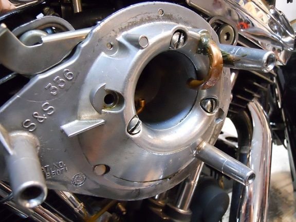

SE air intake system on a 97 RK(used a K&N filter), and instead of the vapor being dump into air filter void area, piped to installed oil catch can isntead.
