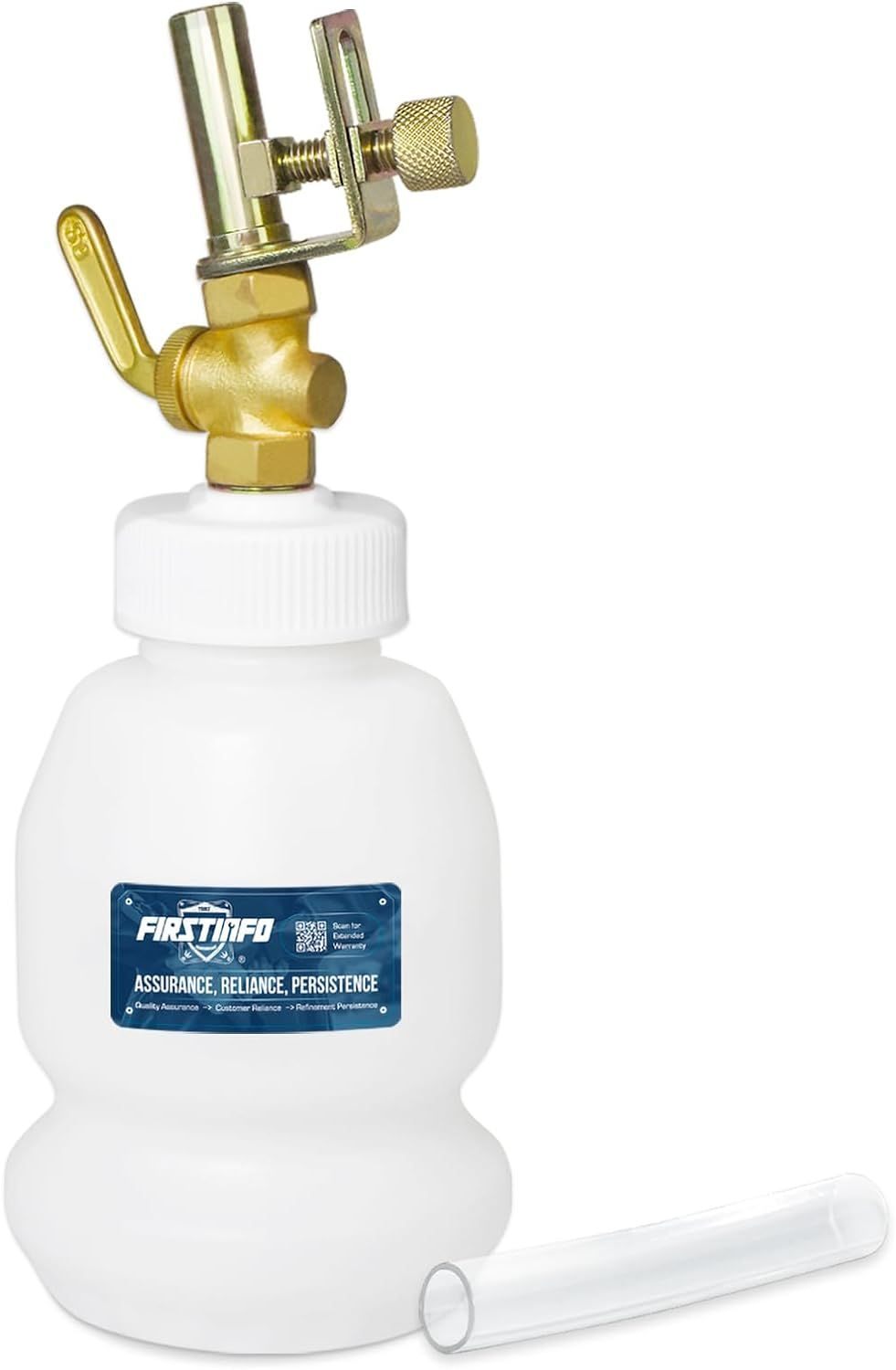

It's time for a brake fluid flush on my Street Glide.
If you've used an automatic refill bottle like this, how well does it work for you?
ETA, I'm looking at this one as it has an adjustable clamp to set fluid depth.
Bleed Bottle Bleed Bottle

I use a Mighty Vac to flush/bleed the brake fluid on my bikes, cars, and truck...
The Mighty Vac kit came with an automatic refill bottle, I circled it in the pic below.
I don't know why, but I've never used it on my bikes....
For some reason, on the bikes I just turn the vacuum bleeder on/off to check the reservoir... maybe because I'm standing right there and not going from under the vehicle to under the hood and back...
I'll have to try it on my bikes next time.
However it works great on my cars & truck!

Just use one of these to refill your master cylinder:
Amazon Amazon
Put the brake fluid in the bottle then squeeze it out into the master cylinder as needed. Of course discard the fluid that is not used when you are done as it will get contaminated with moisture.
I don't know why, but I've never used it on my bikes.... For some reason, on the bikes I just turn the vacuum bleeder on/off to check the reservoir... maybe because I'm standing right there and not going from under the vehicle to under the hood and back...
I've used them extensively on cars/trucks too and they work great.

I could do the same thing by just pouring it from the bottle into the master cylinder. I'm looking to avoid stopping/starting constantly to check the fluid level.

I just blead my brake fluid about a month ago and used one of these. Worked perfectly.
https://www.ebay.com/itm/37548591852...TB3M8Z2KHXZT5H

I use one on my car and truck when flushing the fluid but never tried it on the motorcycles.

OP: How would you attach the bottle to the master cylinder? I don't see how that would stay in place while bleeding at the caliper.
